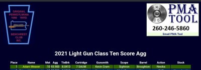

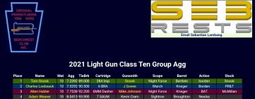

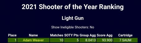

I don't know I think they are fairly competitive...these are all in the 4" area shot @ 1000yd
