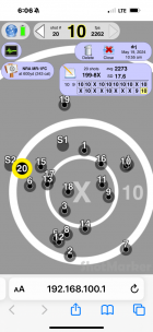

The 110 A-Tip shot the highest score today, at 600, at my club midrange match. There were no clean scores shot, and this was the sole 199 in tricky conditions. I’m proud to claim it as my own, and I tried as hard as if it was the December championship.
I have had only positive experiences with the 110 A-Tip. I shoot it out of a .243 using Lapua brass, and several powders work very well.
The 110 A-Tip at the velocities I shoot it is right on the edge of being a viable 1,000 yard F-Open alternative in many range conditions.
Don’t have the desire to rub a dozen genie bottles in the age of scarce components? Rub this one!
