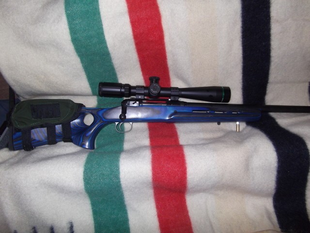

Built this, Savage action, Shaw Barrel, SSS trigger, Boyds stock and Vortex 6.5-20x40mm target dot. Very utilitarian but gets the job done.
And won this with it.

what are your impressions of the Boyd stock? pls be as detailed as you can.
The Boyds stock is nice, fit is good, I shot it without bedding it and it shoots very small groups. I won an egg shoot with it. It is comfortable. My only complaint would be that the wood feels soft, I'm seriously thinking of adding pillars and bedding it but it is shooting so well that I haven't messed with it, kind of waiting to see if it ever becomes a problem. I have the same stock on a Mini Howa that feels the same but again the rifle shoots great. I did pull the Boyds off the Howa and put the factory stock back on for coyote hunting as I find the thumbhole stock awkward for hunting.
