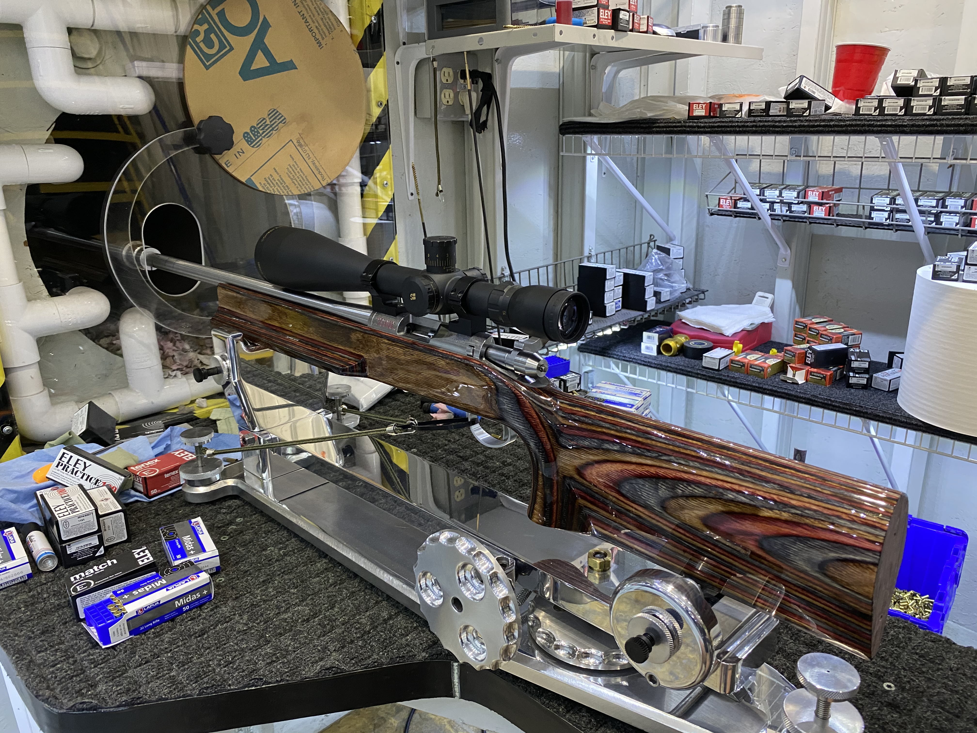

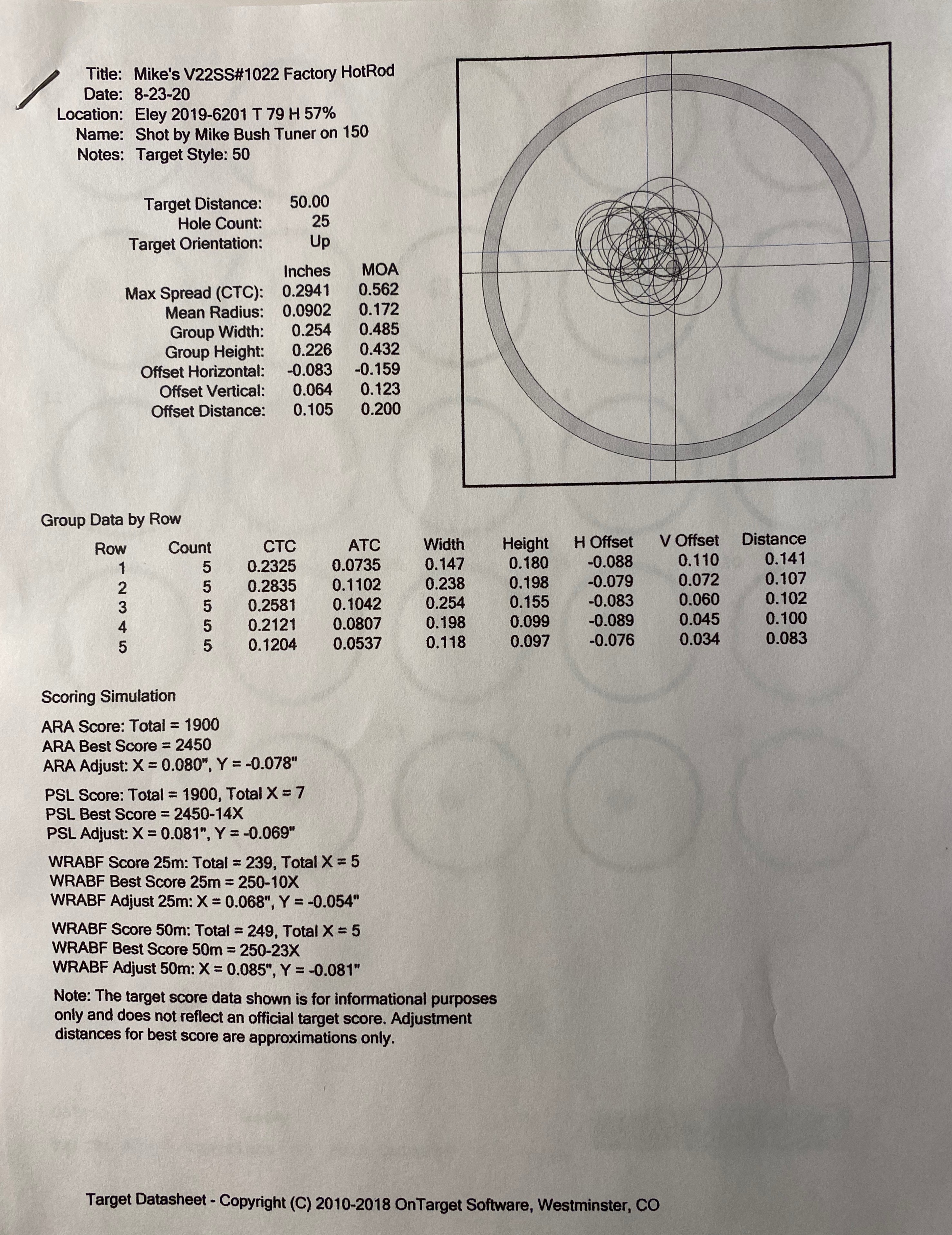

Ok, here's a bit of data from the first V-22S Factory Hot Rod. I carried the barreled action to KY and Jamie knocked out a stock in record time and then, off to Ivan's test tunnel. Tuner on, a bit of dialing to see what it wanted, shot a few rounds from a couple different boxes of Eley Black Box and shot my first ever BR card.
V-22S Single Shot Action
Mueller Barrel (yes, this is one of the four I slugged early on and after a wee bit of finish lapping, I'm likin' it)
Pro-X Tuner
Vudoo/Flavio VS-BR Trigger with Vertical Fire Control
BBRS Custom Stock
I know a few guys have thrown around the question, "yeah, but is it going to be competitive?" Well, I do believe so....
Thank you Ivan Wells and Jamie Burgess for an incredible amount of work in a really short amount of time. You guys have impressed me time and again and I appreciate the hard work.
MB

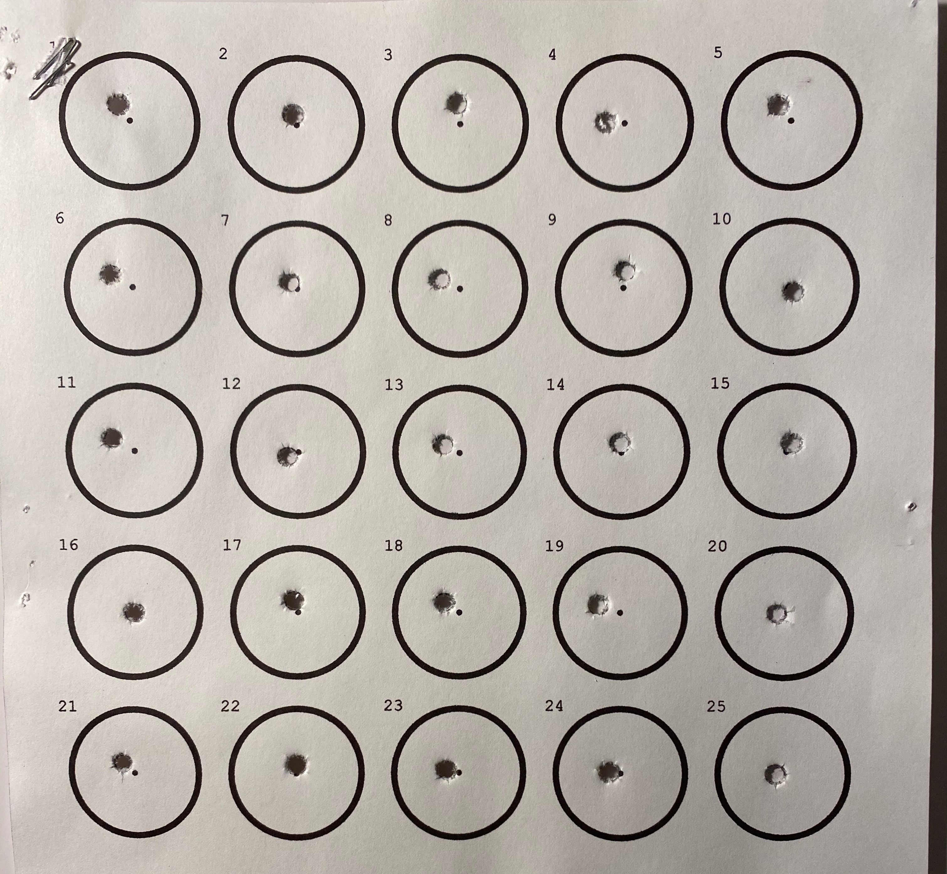

Hello Guy's, I was shooting my Vudoo Repeater with a single-shot adapter and a "great" lot of Midas Plus this weekend at the GA State & Black Hawk Open match when I shot that target. It was really a great, fun and competitive match.
