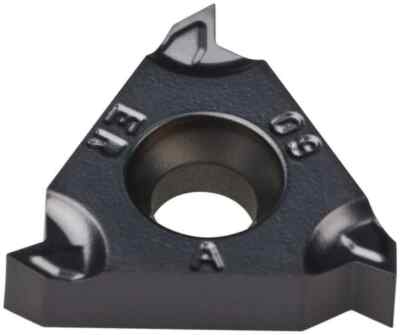

Top Notch threading inserts and tool holder
What they're telling you about the BXC inserts is right on. They do a great job at low rpm on stainless. Still, they do better if you can run them at about 200rpm or so. Same with BMA inserts but they like a little more speed, still. Both do well though, even down to 70rpm or so but that's slower than ideal, for sure. The closer you can get to ideal speed/pressure, the better the finish will be. You have to look at carbide differently than hss. Hss cuts where carbide, for lack of a better way of saying it, kinda melts it off and is dependent on heat at the contact area for best results. Not the best way of stating it but it's apples and orages when comparing carbide inserts to hss. You just have to keep in mind that heat is a big factor in how well carbide will cut vs hss. You can cheat it a little with using a little heavier cuts with carbide to get that heat at the point of contact. Most of that heat goes away in the chip so it's not a huge deal but that heat is exactly why hss is best when talking about inducing or relieving stess in the part being machined. This is why I almost always use a very sharp hss cutter for crowns, fwiw.
Bottom line, the bxc grade is the best choice for most bbl work with bma being another good option if need be. Just play with speeds/feeds and pressures to get a finish that you're happy with.

I have Carmex BXA and MXC coated inserts. They work great as all said, but the Iscar laydown with IC908 coating do even better. Slow or fast they cut phenomenal. For slow manual speed, it's all about the coatings. I also have HSS and the Warner stuff, but I will take the good carbide inserts all day long, manual or CNC.

These posts are why I love this place…so much to learn. Thank you all for sharing. I knew most of this because we’ve talked or I’ve talked to others but it seems there is always something else to try. I’m using the BXC inserts, not the thread specific ones. I think I finally switched to a second edge but I can’t tell you how many I’ve done on that last one. Threads still looked good but edge looked beat up a little in a lope. I’ll order the Iscar to try.
I used to do compound but I’ve switched to straight. You should’ve seen the look on my face when my mentor said ”Why the hell are you doing it that way with that insert? Just go straight it, that is what it’s for and it’ll be way faster”. He ain’t been wrong yet ;)

I usually start out with a heavy plunge cut, straight in. As you get closer to finished size, the chip load on the tool gets heavier and I go to the compound for the last couple of passes. But more than one way works, especially with modestly fine threads vs something really course, like a 4 tpi or so. Lots of area in a deep, coarse thread like that and hence, a lot of load on the cutter. It'll work but is more likely to chip or break the insert, ime. I tend to get a little better finish using the compound for the last passes as well.
Machines are all different, you will need to experiment. Insert types and grades will not work for everyone. My old lathe did not like laydown inserts, the top notch worked great. New lathe works with the lay downs great. I have not found the speed to be all that important. I can get the same finish at 50 rpm as 400. The grade and edge prep of the insert is the main thing. Figure that out and everything gets happy.
