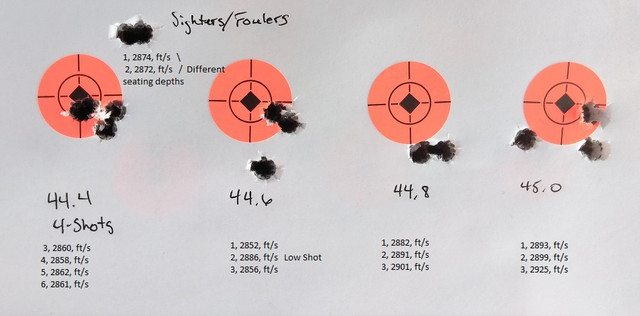

But now, the question becomes, 44.4 with the GREAT ES or 44.8 because of the great vertical and the dip in POI?
If sighters had varying seating depth and grouped do you have those depths noted.
I would probably re shoot both .4 and .8, for goofing around nice job.
No, I didn't note them. :( These were all slightly into the lands and the first two were seated too far...that is about all I remember.
I think you're right though. Try both weight charges again.

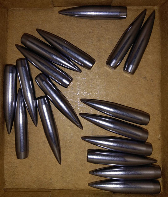

My only dilemma was this...
Snapped a picture of the lot number with my phone and headed to the LGS today. Luckily found another matching box. Getting moly coated now and more shooting this weekend!
