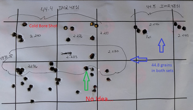

Here's the OCW test with 136 scenar L 1565103063543232492468229599994.jpgruger american predator 3x15swfa
