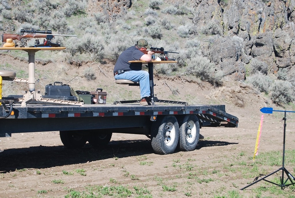

We bought a used ladder rack and fired up the welder. Axle hubs, swivel chairs, umbrella holders. When we want to move within the field we put the guns away, put the rests and other gear in a tote mounted on top of the the rack, lay 2 stabilizer poles in the bed of the truck and drive across the field.
This summer will be the 9th year with the ladder rack. The altitude gives a great field of view

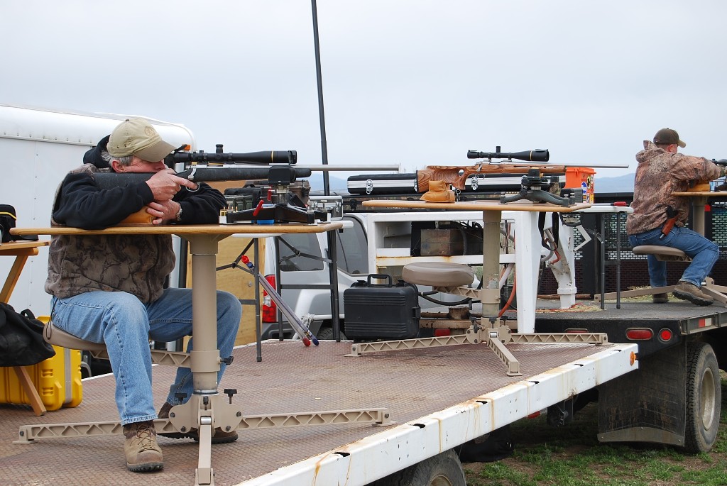

Saw this setup out in OR last year in the motel parking lot. Did not talk to owner or see it in action. I would probably fall off and hurt myself. :D IMG_4072.JPGIMG_4071.JPGIMG_4070.JPG
Yup, I remember the RASS, it had the dreaded "trip feet" that absolutely guaranteed you'd trip over the things in the field while off the seat. It also had no room for any kit you'd normally find on a bench top used for shooting rats or PD's like ammo, bino's, range finder. No wonder it was discontinued after a couple of years. (That pic looks like it was taken at the Rimrock Motel in Alturas......)
But it appears the truck owner knows the benefits of some elevation with his bed platform. Sort of crude, but it probably works. Just don't stand up too fast and loose your balance. Some of our rancher buddies let us use some of the ranch rolling stock for getting that critical elevation advantage; most appreciated.
