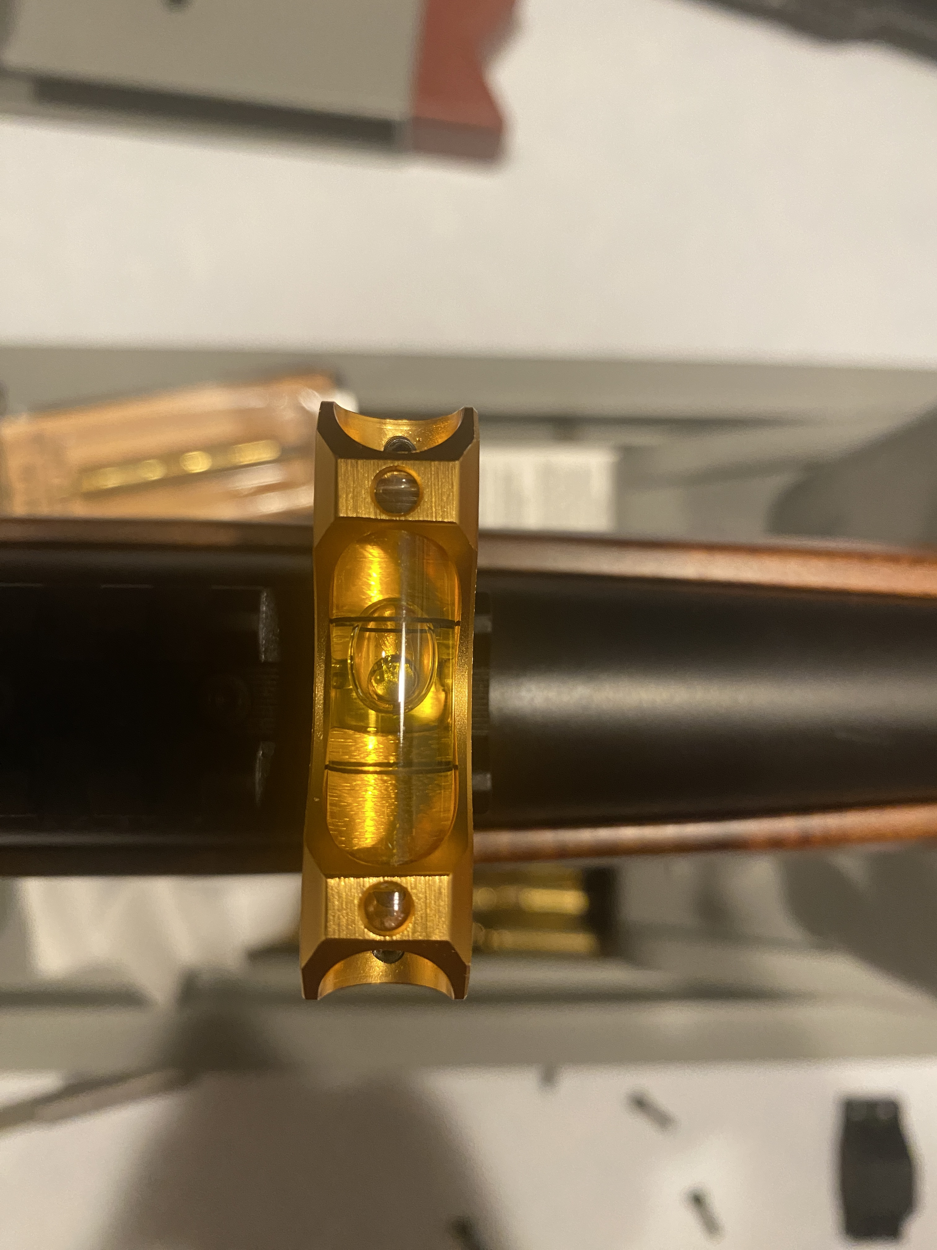

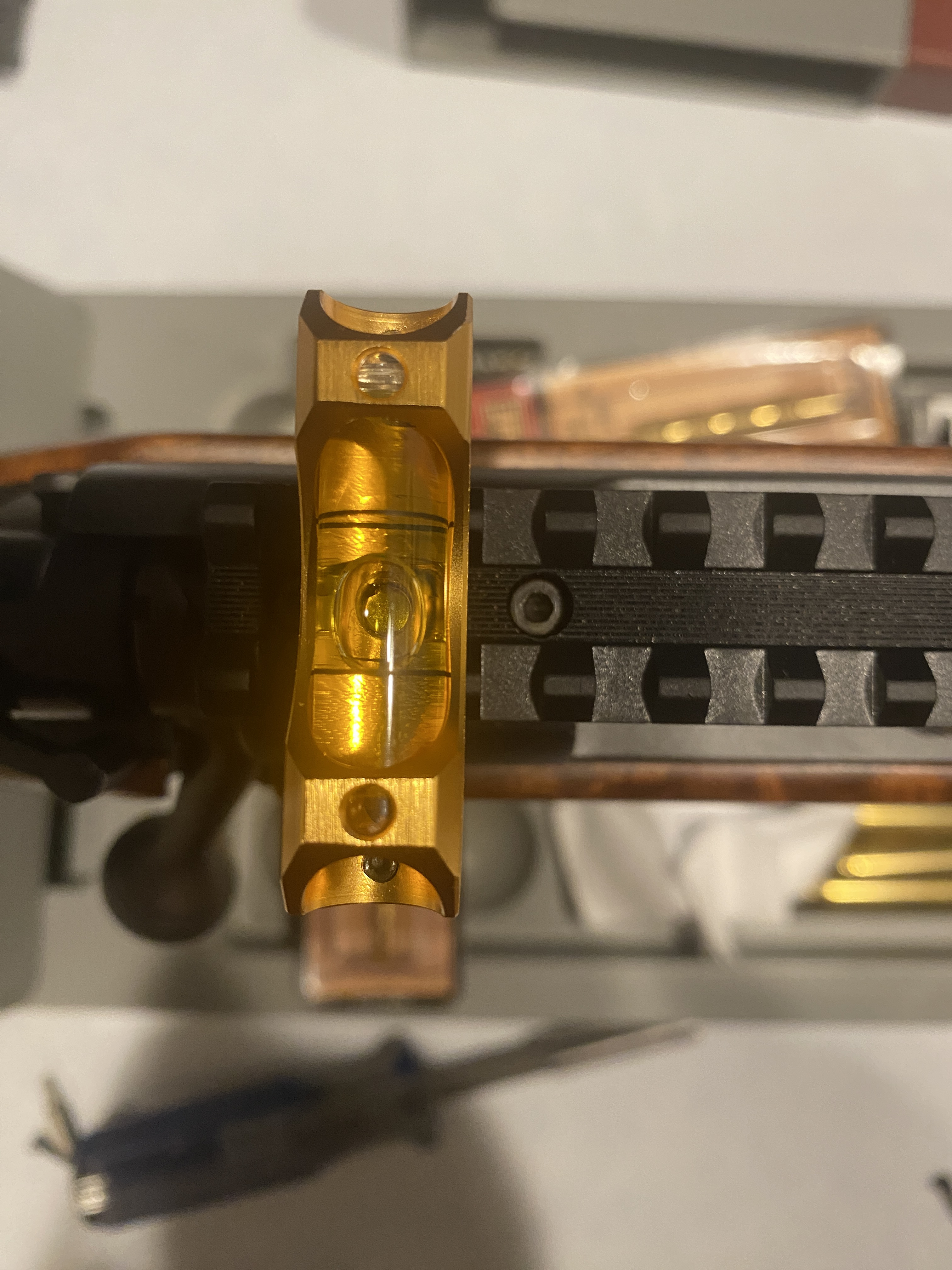

I've had a rifle sitting in the back of my safe for a while. I purchased a 1 piece rail (0 MOA made by EGW) and mounted it when I first bought the rifle. I've never fired the rifle.
I've finally gotten around to buying a scope for it.
I'm using the Wheeler scope leveling tool to mount the scope.
First thing I noticed was when I mounted the rings to the base, the level wasn't equal at the rear and front of the rail. It's off quite a bit. I pulled the rail off the gun and checked level on a flat surface and it's equal at the front and back. Seems like it might be being twisted when mounted to the gun.
Here's a couple photos showing what I'm seeing. Is this something to worry about? Thanks.

This is the exact reason I stress free bed one piece rails. Use Devcon 10110 or MarineTex.

The base is fine when checked off the rifle & on a flat surface. I can remove the front two screws and the base levels up. So, obviously even though there’s no visible gap at the front there must be one because it’s when I install the front screws it goes out of level. Would placing a shim under the front be an acceptable fix? I have a Starrett shim kit that goes down to .001. This is a hunting rifle, 400 yards max.

Sounds like either the scope base or the action has the scope base screws drilled slightly off center?
Either that or the action is warped. Have you or anyone else swapped barrels on that action?
Browningwgm good morning screw the front of base to the rifle, shim the rear, cut your shims to fit under the base, locktite.
If you don’t like the looks bed it with shim in place, Brownells sells shim kits for different actions.
Shimming, bedding, lapping ( remove high spots only) all have their place on a hunting rifle.
