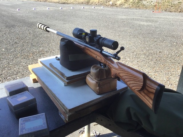

When this level is folded out I can be looking thru the scope with my right eye and I only have to glance up with my left eye to check the bubble. I don't think most people realize how much (without a level) they cant their rifle, or how much the cant will throw your POI off.

Regarding my level, look at what I said: "When this level is folded out I can be looking thru the scope with my right eye and I only have to glance up with my left eye to check the bubble."
My right eye is centered in the scope and without moving my head .001", I can just glance up with my left eye and see my entire bubble housing. The parallax knob is never in the way on any model NF. I will try to snap a photo of what it looks like from the vantage point of my left eye when my right eye is in the scope, but trust me, the knob is not in the way at all. And of course, a left-hander can flip it 180 and have it on the opposite side.
Like you say, if I am shooting at LR I am constantly checking that bubble. They are made by Flatline Ops. They are spendy but worth the extra money to me. I have used several other brands. They all work fine (well, until they leak or break), but I find this one more convenient to install, adjust and use. Not an advertisement, it is the nearly free "Plumber's Tall Target Test" I am trying to get people to try. No need to discuss hypothetical shortcomings -- just try it. You will never mount a scope without using it again.
As long as your Flatline Ops is the version that mounts to the scope itself(not rings or rail), and you can see it at shooting position, then it's perfect. That's exactly what I'm advocating for.

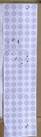

I use a level after I know my scope is on straight, not during the mounting process. Like you, I ry to make sure the vert. crosshair is pointing at the bore, by eyeballing. Then I do the Tall Target Test to see if I got it right or not. This time (.30-06 shooting cast lead bullets for silhouettes) I got lucky and got it spot on the first try.
Ignore the holes in the middle of the Tall Target. After I got the scope sighted in at 100 yards I used a plumb-bob to make sure my bullseyes were exactly plumb, then fired two shots at the bottom right bullseye. Then I cranked the E turret up 27 MOA and fired two more shots at the same bullseye.
Because those last two shots hit the bullseye at upper right, exactly plumb above the lower bullseye, I know my scope is on straight
Now I can sleep well at night. :)
Another simple task many make difficult. A plum bob. Align crosshairs. Verify as KY Windage showed you above.
