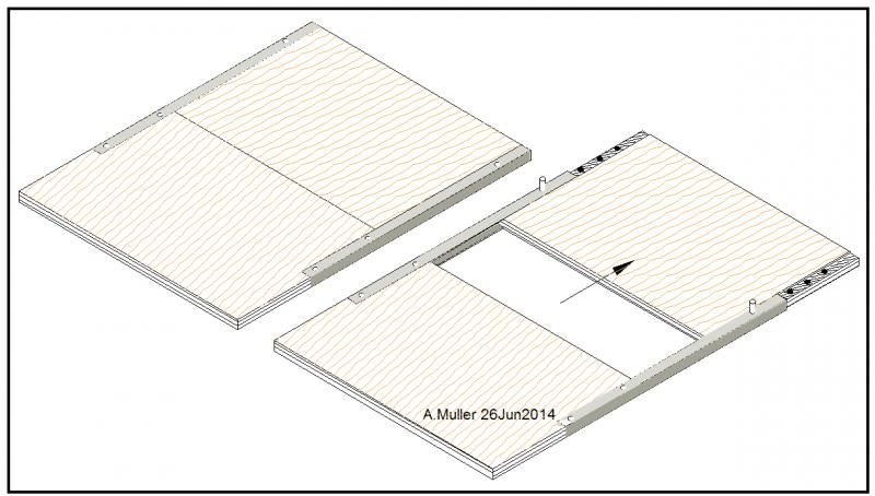

Bryan actually used the latest and best adjustable board. See picture below:

Who doctored that picture. Shiraz, that was you. Great idea. It can be separate boards and the rules do not specifically say that the separate boards cannot be joined. Interesting.... I like it.

I read this thread earlier today, and while we wait for a clarification or change of the rule, I thought I would make something like this in the meantime; however, I do like Shiraz's version better :)
