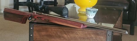

I had an aluminum plate that was once used as a rear rest. It had a carrying handle and 4 adjustment screws. I had a left over piece of bar stock from another project and decided to build a leveling mount for my scopes. I didn't do the work myself but told my gunsmith what I wanted.
The mounting device is placed on a table and by adjusting the 4 screws the base will be perfectly level. The scope is first placed on the rifle and I set the distance for my eye to ocular and get the rings set on the rifle.
The scope and rings are transferred to the leveling base. By using a vertical line, the vertical cross hair is line up with the line. The rings are tightened down and the unit is placed back on the rifle and it's ready to go.
It's really fast. I can level a scope in less time than it took me to write this up.
