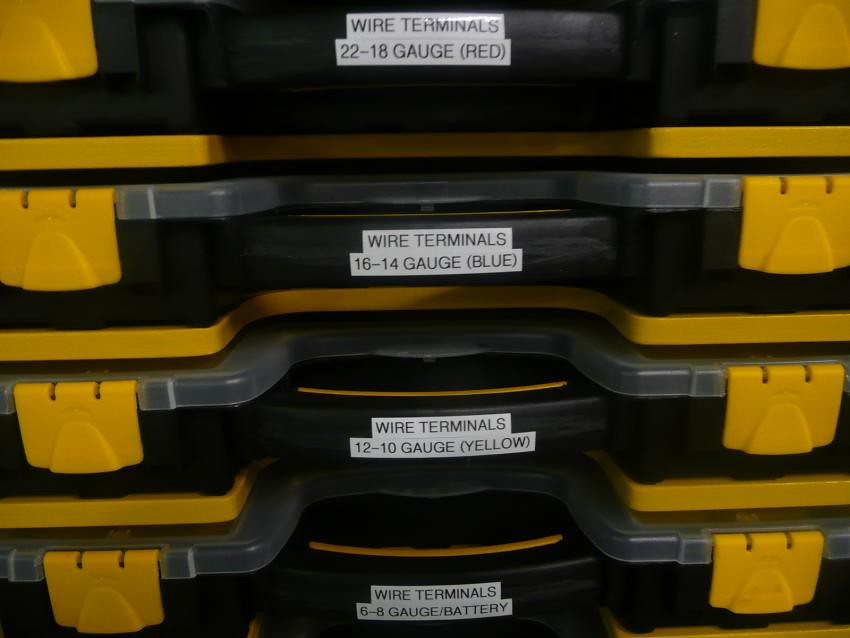

Those HF boxes look better than others I've seen. So I'm curious . . . with 8 or more boxes stacked like that, how do you label them to find what's in them? MY memory would make unlabeled boxes a nightmare lol.
Since I never have to take them out of the "reloading room", eventually I went to a couple of vertical drawer bin cabinets so that their front labels would all be visible at a glance.
I'll make printed labels for the front of the handles. Most often used items in the top slot in the cabinet and so on as we go down.
