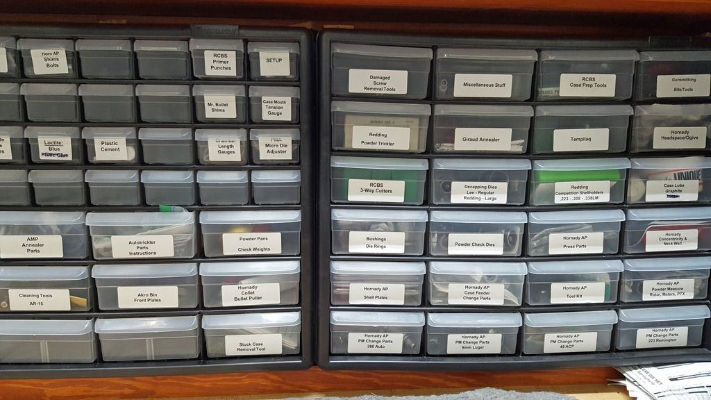

I'll make printed labels for the front of the handles. Most often used items in the top slot in the cabinet and so on as we go down.
Not my picture but something like this..
And I imagine you could place labels on the top surface of the storage box to differentiate similar looking parts for, eg, different calibers or different tools. I wasn't creative enough, so I went with this approach so for many part types the contents of each cubby are visible:

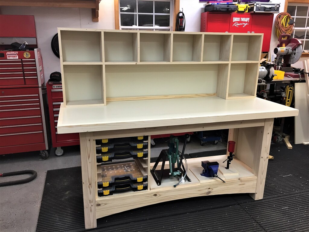

Thank you and yes on the back. I've rabbited all the pieces to accept 1/4" melamine to match the top.
What's the advantage of using the melamine...just cost? The last couple of benches I've built I've used raw butcher block slabs, and I really like the weight and simplicity.
I'd have to think it's availability, appearance, durability and 'clean'ability. It's resistant to most common solvents too, which is helpful. I've used high-pressure laminates too (Formica) but that can be costly as well as requiring more work to apply for marginal (if any) benefit.

Melamine is resistant to chemicals, water and such and super easy to clean. Melamine is also very stable, flat and heavy especially when it's laminated on additional layers of mdf. I've used it for may benches in my shop. It's just a great product for these type applications.

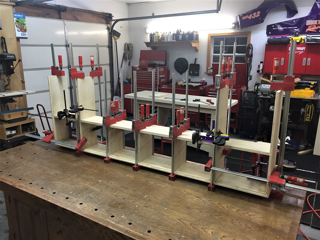

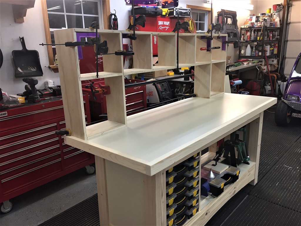

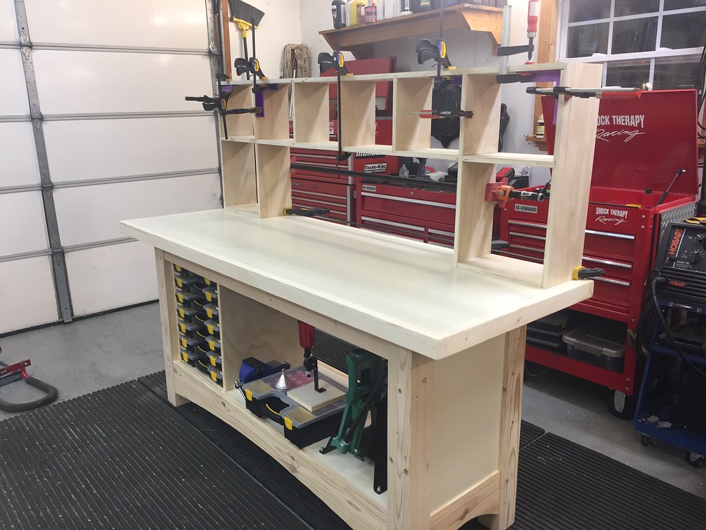

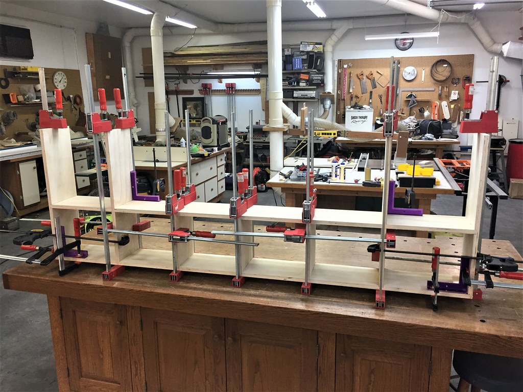

Continuing on the project and back under the heading of you can never have too many clamps, I give you the hutch glue up. lol... :confused:
I have also decided to build a cabinet of drawers on the other end of the bench that will mirror the size of the HF plastic bin cabinet. Have 100 lb. full extension slides ordered and will pick up material for that tomorrow. I'm really calling it done after that.
Terry,
I count 20 clamps, that is impressive. I thought I was doing pretty good with 10 (five sets). I must admit, there have been too many times I could have used more. Will have to look for some more in the auctions that I attend.
As to your comment that after you install the drawers you will be done, I must say that I doubt that you will be from what I can see. If you look at the some of the benches shown by others above, i can see this project as a growing project as your needs grow. Lets just say "Done for Now!". LOL

Ok, I give you the it's never really done deal. lol... Lets just say that after the drawer cabinet I'm going to wipe some poly on it and move it into the reloading room. :D

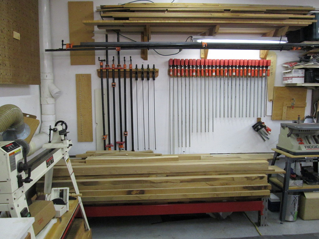

Many years ago I was part of a huge woodworking forum group buy on the Bessey clamps. I bought virtually all I have on that deal for just about half price.
Those Bessey clamps are some of the best. But I can see that you have a few of the good old pipe clamps. Can't beet them for adaptability. I have a few of those and many lengths of pipe for adjustments.
