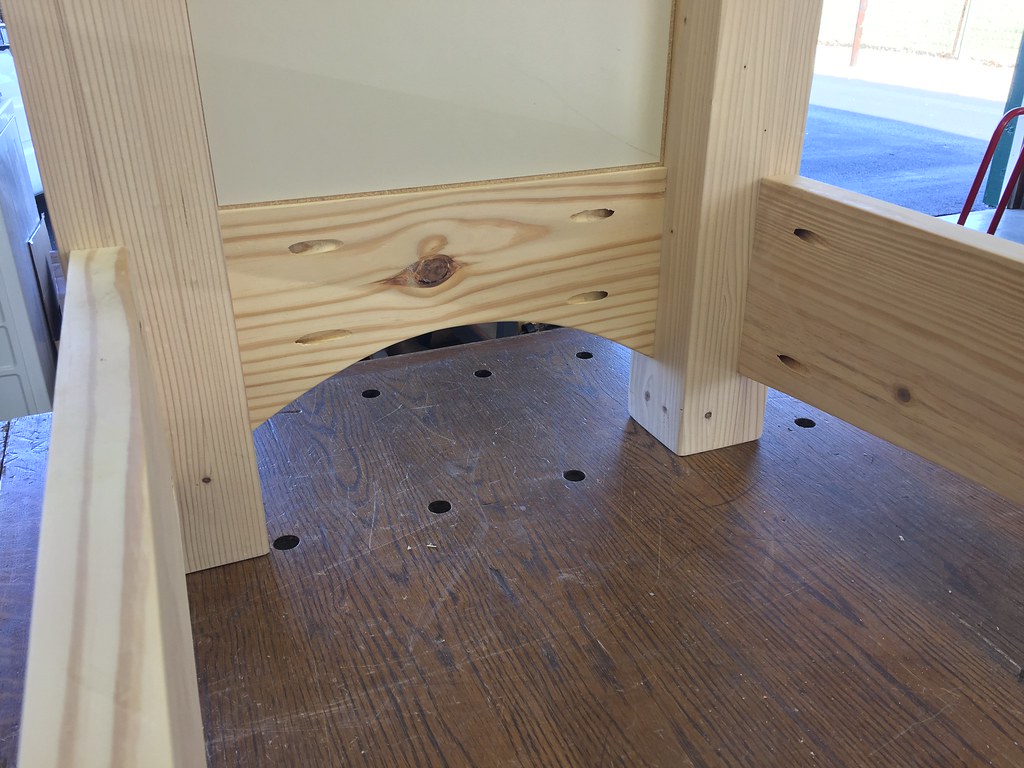

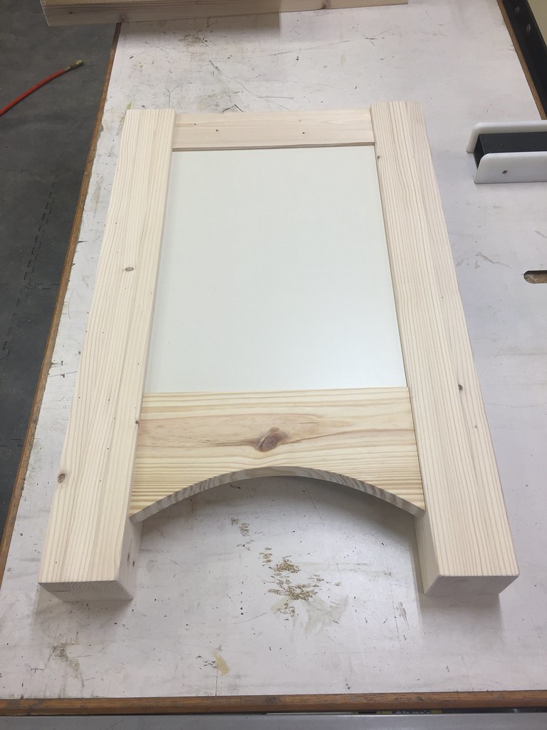

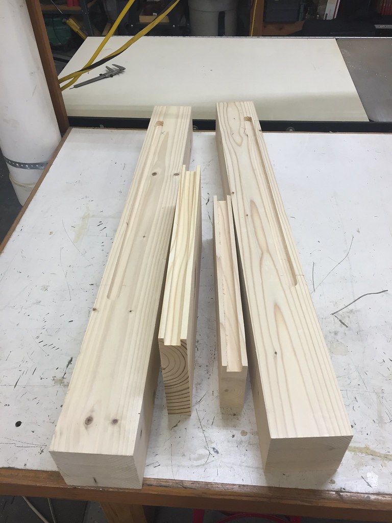

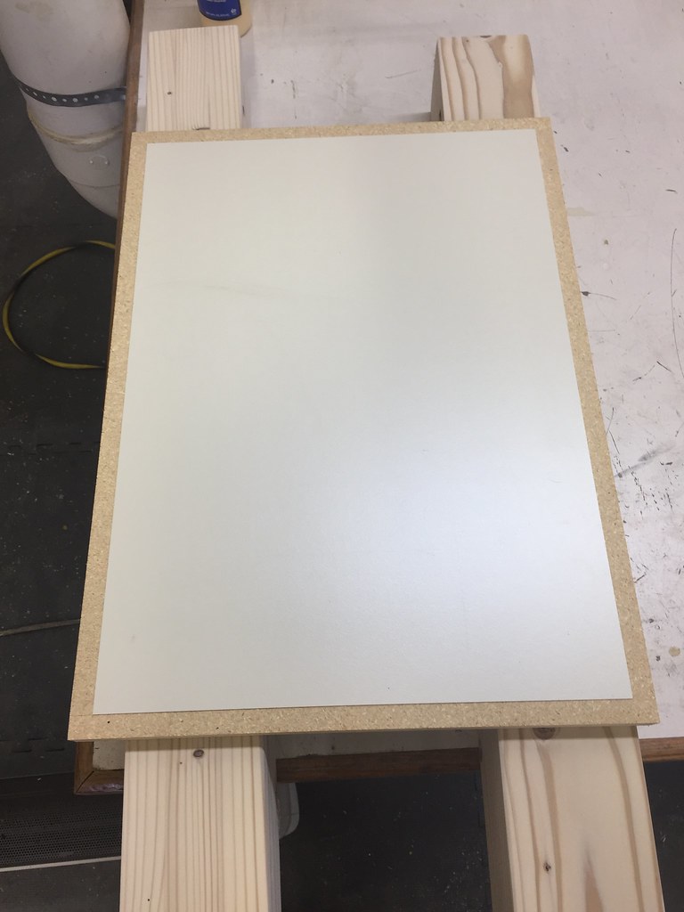

Was out in the shop early this morning. I cut the rails for the end panels and routed the grooves in those and the legs to accept the melamine insert.
Melamine is oversize to I cut shallow rabbits on the back side of the panel to fit.

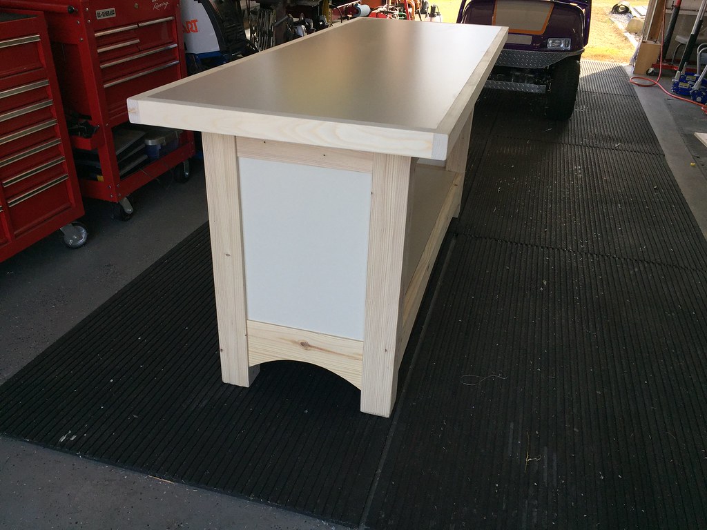

Dry fit after cutting the curve on the lower rails.

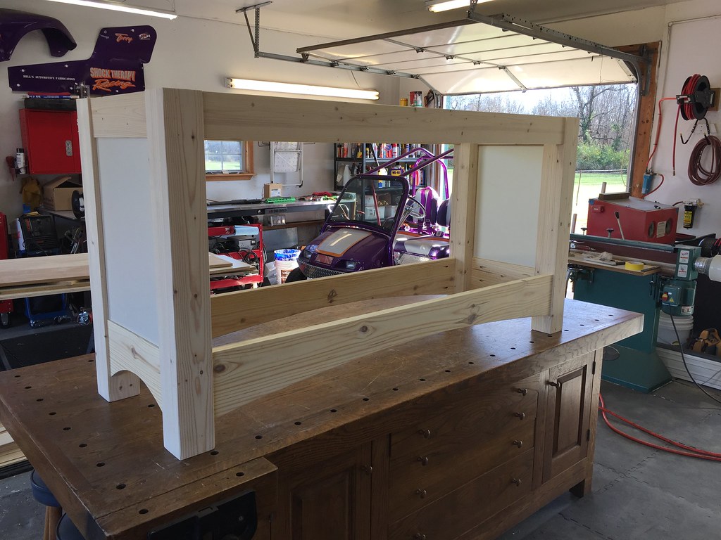

Once proper fit was confirmed I drilled for the pocket screws and assembled the end panels. I cut the curves on the long lower rails and drilled for pocket screws in those as well and assembled the base.

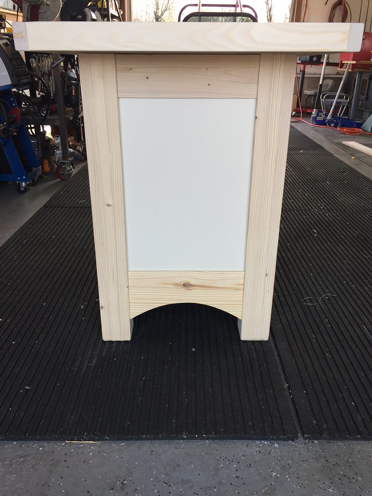

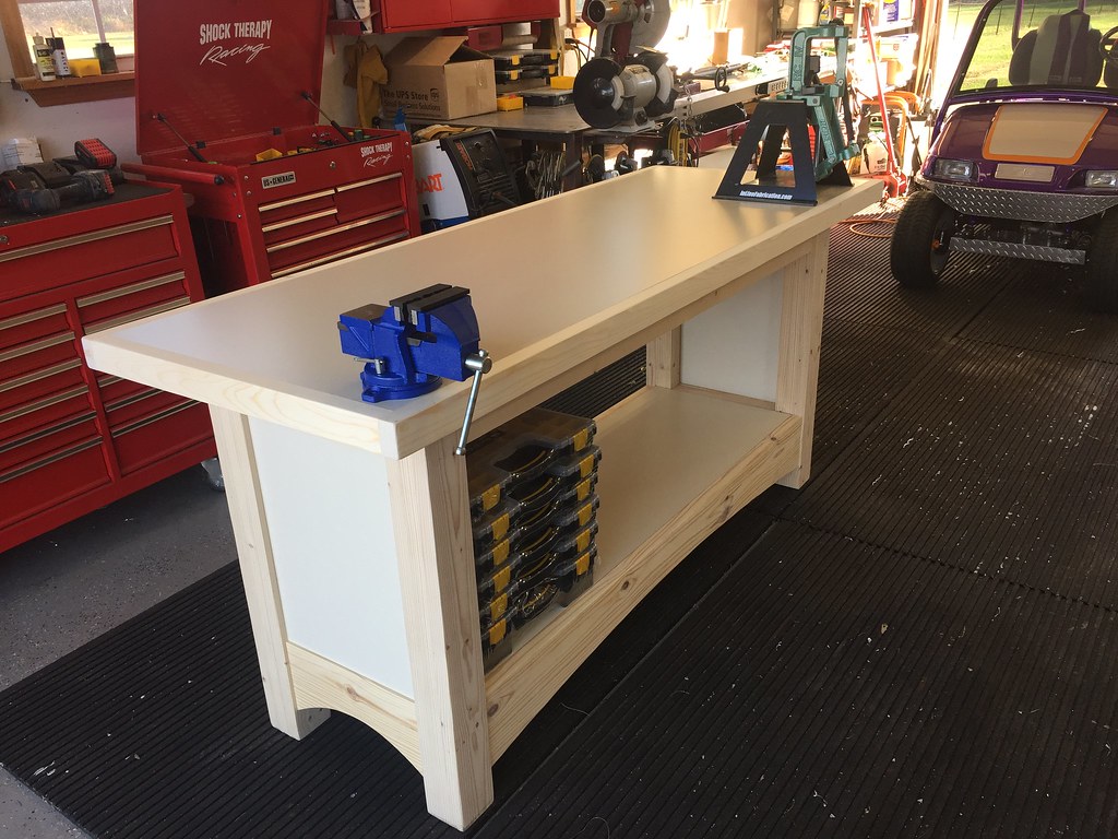

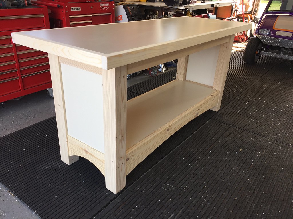

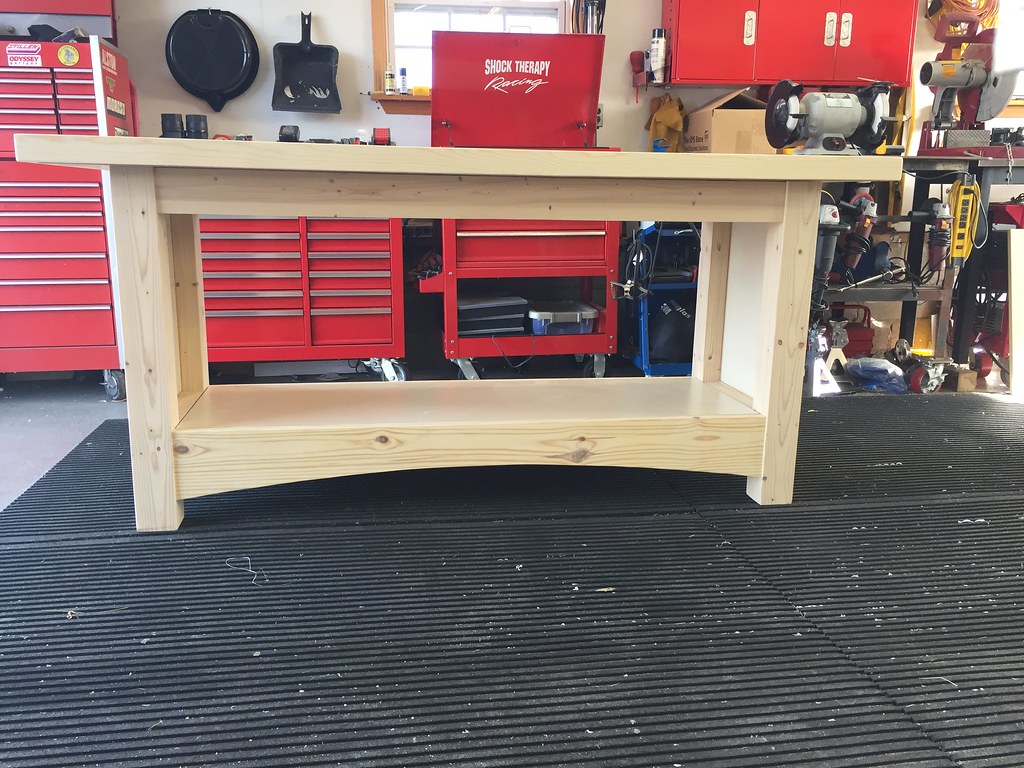

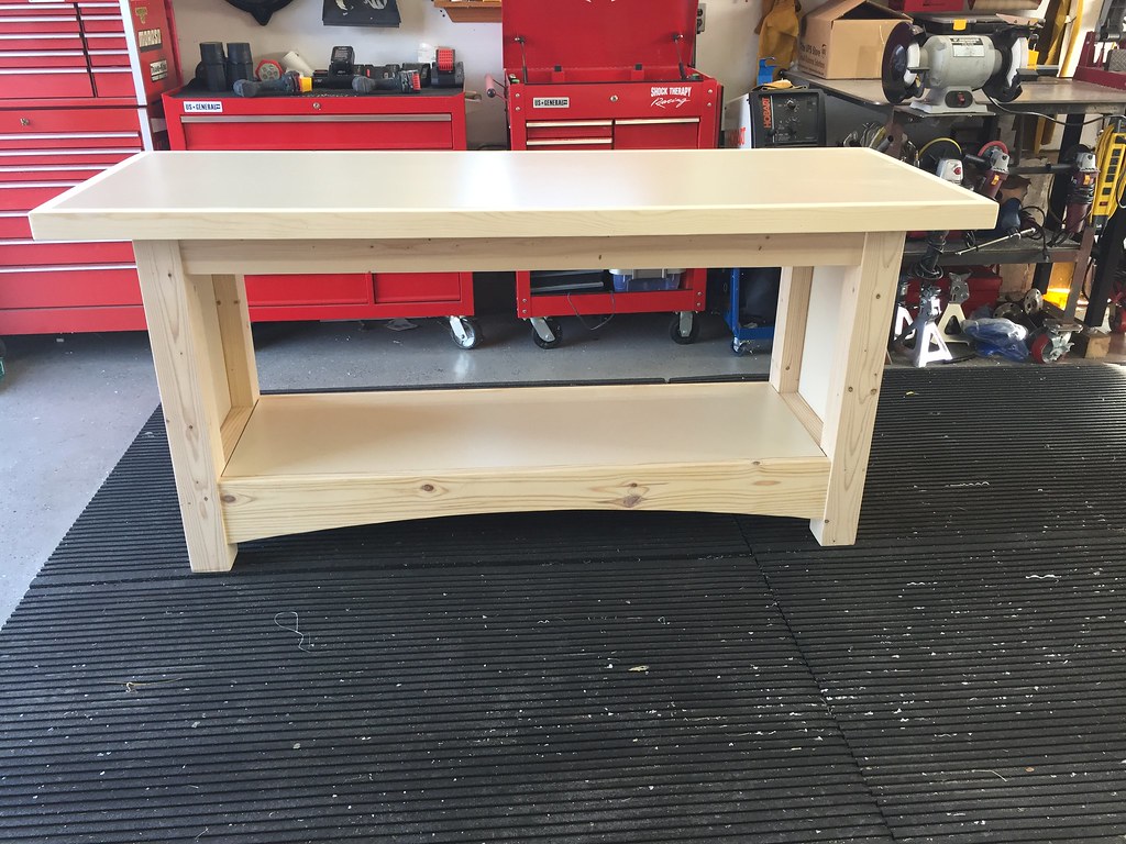

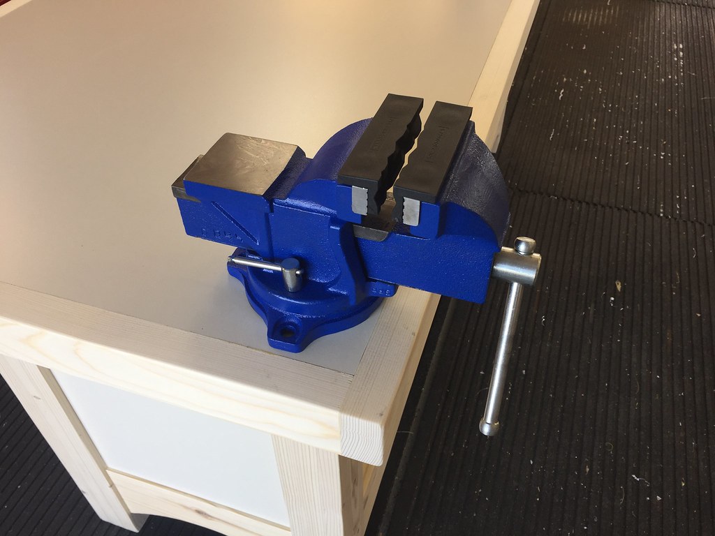

I added supports for the lower shelf and cut the melamine and installed. Once the base was assembled I moved it onto the floor and added the top. I kinda like it. Sill need more sanding and then I'll put a few coats of wipe on poly on it and call it good.

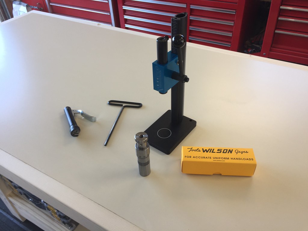

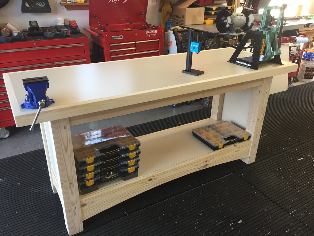

Quick trip to Harbor Freight for some storage boxes. Seems there is a ton of peripherals involved in this deal that need a home. Going to build some sort of cabinet to house these boxes. UPS man was kind to me today as well. Got the 4" Yost vise and soft jaws, K&M arbor press and primer seater along with my Wilson setaing die.
If your bench is to be up against a wall, put a piece of thick foam rubber in between to seal the gap. Things will find a way to roll off the back where they are hard to get. And if wall mounted, some shelving above would be helpful. Nice bench!
Very classy table. It looks more like furniture than a loading bench. Lots of nice touches with the curves and the mortise and tenon joints and the pocket screws.
