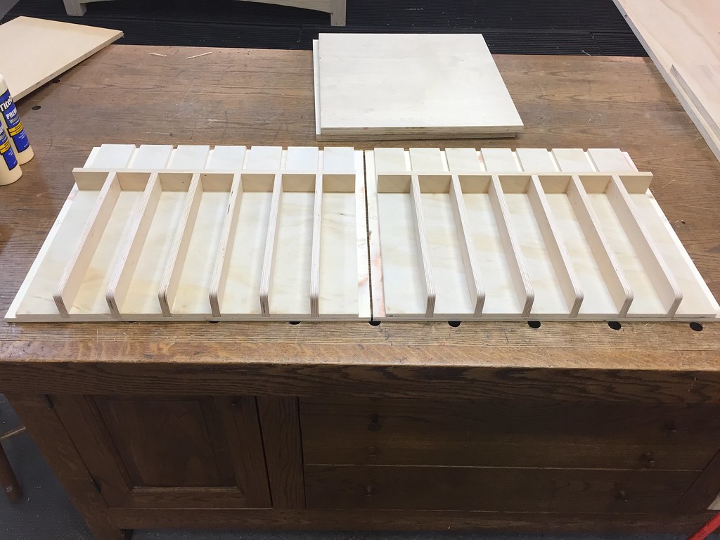

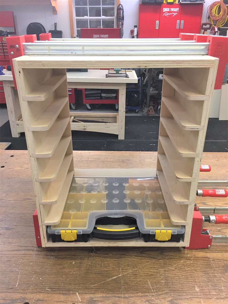

After visiting my son in KC the last 2 days, I stole a couple hours of shop time tonight. I'm going to use the Harbor Freight plastic storage boxes to store as much of the reloading odds and ends as possible. A cabinet is in order to store the boxes. I decided to make the cabinet fit under the bench. Little bit of plywood and some milling and poof, it's a cabinet.

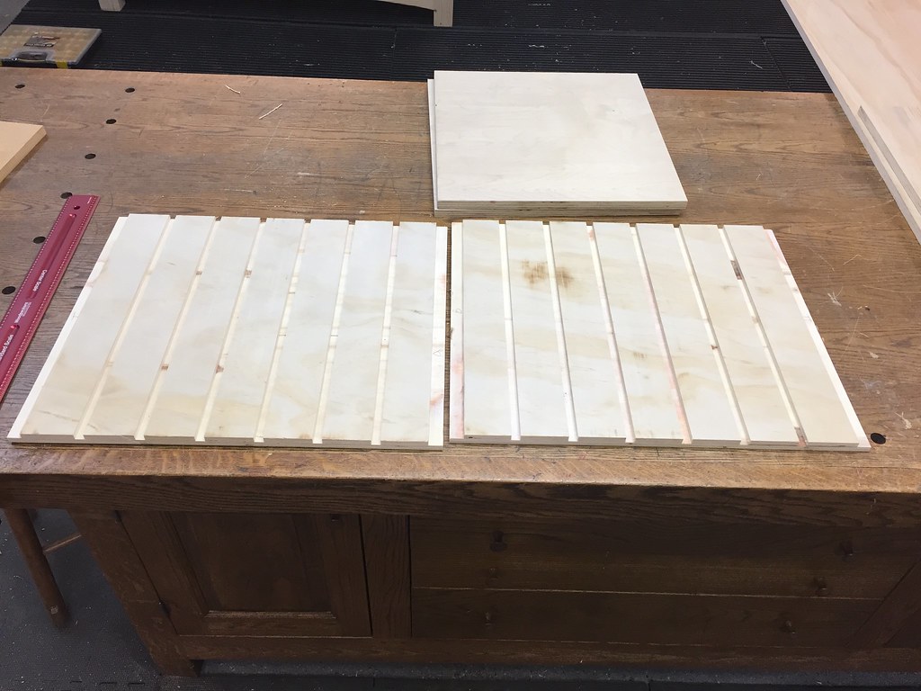

3/4" plywood with grooves for 1/2" Baltic Birch runners.

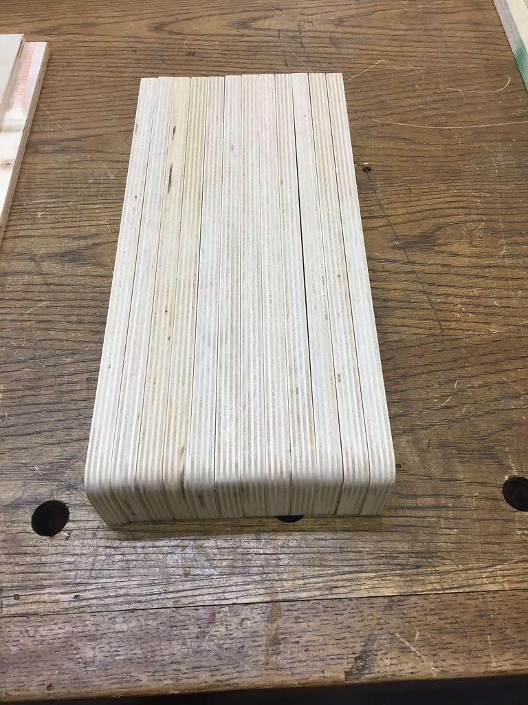

And the 1/2" BB ply runners shaped and sanded.

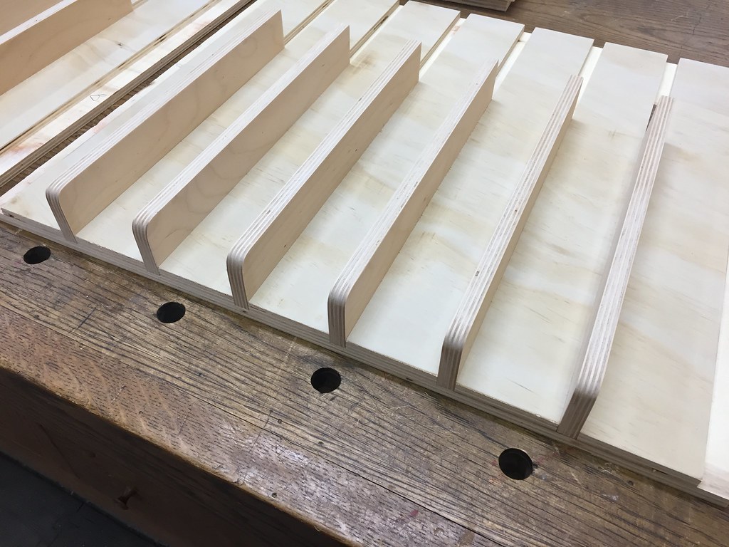

And with the rear stops glued and pinned in place.
And the completed glue up. Just need to edge band the frame and wipe on a little poly.
Terry, another idea worth considering might be to make flat trays, possibly with low dividers to kind of keep things from moving around... but use bullet or brass boxes for parts containers. Not like you'll have a shortage of them ;)
I've tried the factory made parts tray/boxes and they do work pretty well, but they seem to break awful easily and inevitably when I need a replacement, they've stopped making that particular size/configuration... :/
Thanks. I've used these boxes for many years already. Never had any issue with them even dragging all over the country to race tracks etc.. They been making them for many years in these configurations so I'm pretty confident in the boxes and that HF will continue to produce them. Hard to be for $7 each if you have a coupon.
