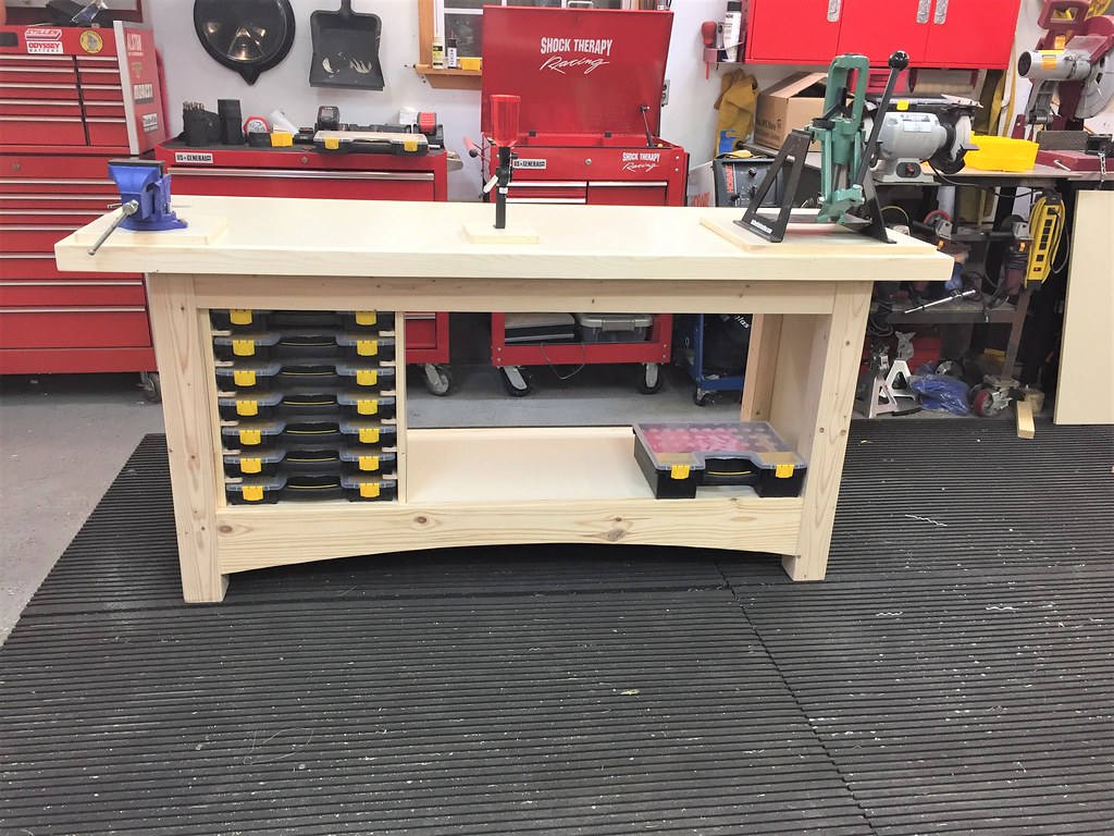

Reloading bench build...
Nice handy work Terry, although it is just another rectangle bench.
An "L" or wrap-around top would allow easier access to well laid out reloading eq, without having to side along the table front. You can always add to your bench as you look to have the room.

Would have loved to been able to do an L but need to share the "gun room" with the wife's workout equipment. This is all the space I am allotted. :D
Terry, you might want to consider adding some shelving to the back of your bench along with a back to keep stuff from rolling off the back. Being able to store your powders, oils, dies, equipment, measuring tools, cleaning tools, and special gunsmithing tools will be important to keeping your bench clear or prevent you from having to dig for it from under the bench.
Yes. I'm going to add a hutch to the back of the bench. That's the next project. Trying to figure out what configuration that piece needs to be right now.

Thanks again. I have a metal gun cabinet (not sealed) that I'm going to use to store powder etc... I seriously doubt that I'll load pistol ammo. Perhaps I'll change my mind but I doubt it. My reloading time is going to be limited so I'll need to concentrate on the rifle rounds. That will narrow down the amount of storage necessary. I'm just going to build a simple bookshelf style hutch to begin with and see how it goes. I can always add on or change it entirely if need be. Might need an excuse to build something new in a few months. :D

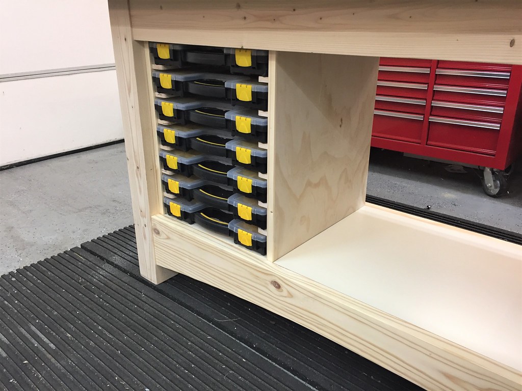

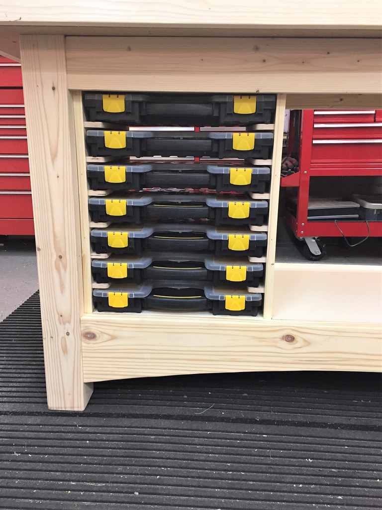

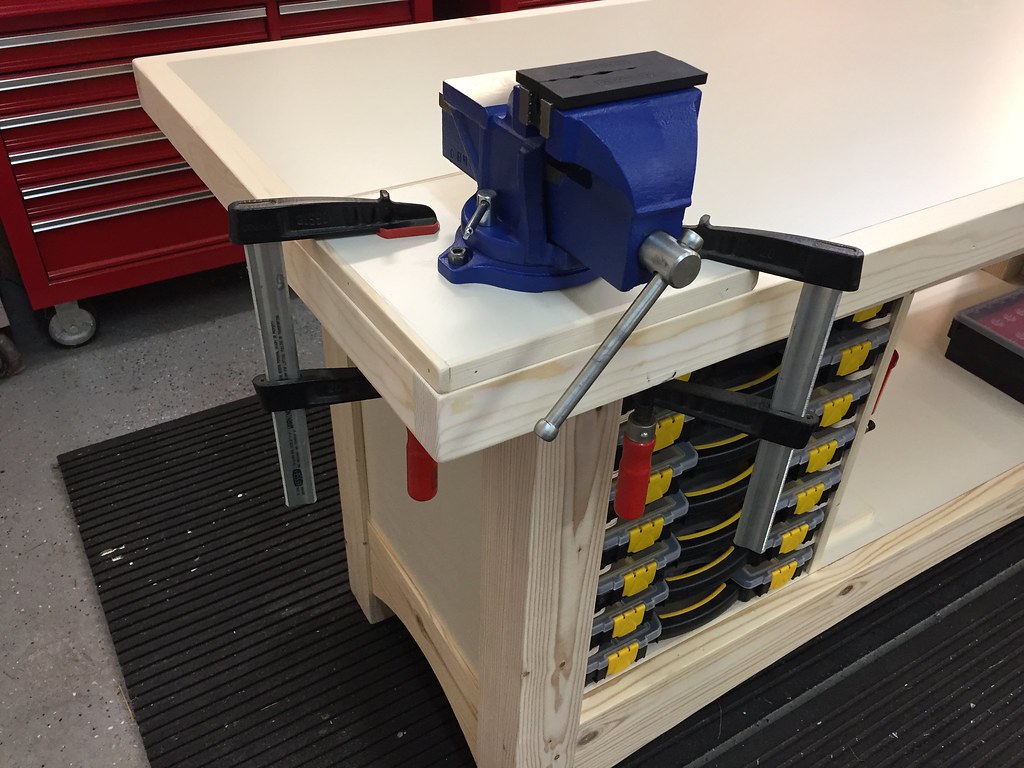

Tonight's progress was not much but every little bits gets it closer to done. Got the storage box cabinet edge banded and test fit. Seems like it's going to work well.

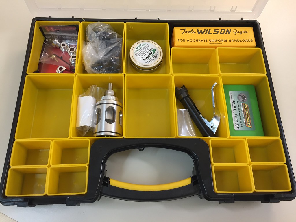

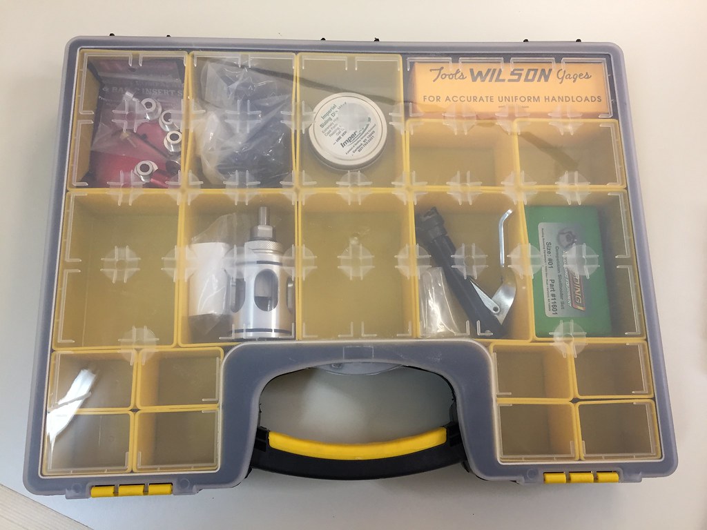

Since we are talking about the HF boxes, I do love these things. I have a ton of them. The removable and interchangeable compartments just work.
The lids have molded in keepers to keep the compartments and their contents in place no matter how the boxes are oriented.

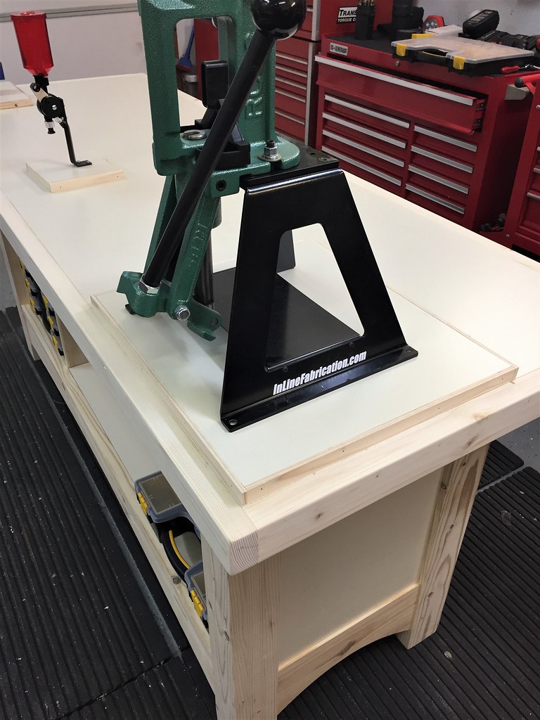

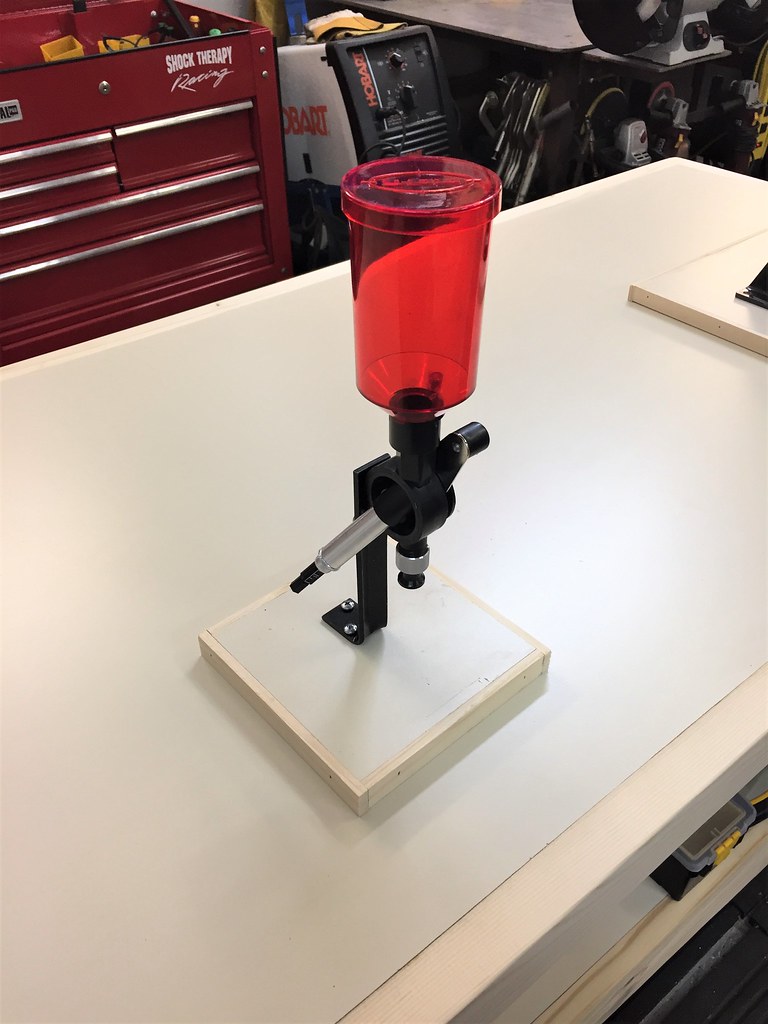

I knocked out some bases for the vise, powder throw and the press. Just scrap melamine edge banded with pine. Countersunk headed bolts thru the melamine will attach the bases. Once I know for sure where I want the vise and the press I'll drill and attached screw on tee nuts on the bottom of the top and use some star knobs for tool-less attachment. I'll just attach to the bench of some F clamps for now.
