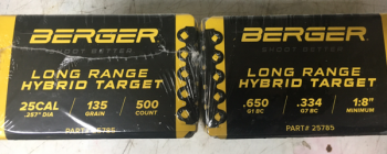

Berger 135s are starting to show up @ some retailers who ordered them.
update: 7/9 -> all sold
these showed up the other day from McGee Stocks:
Really wouldnt mind getting a custom throated 257 rob to try them 135 bullets but i feel like they would be better suited to something with extra hp to get velocity up where it would shine better
Haven't found one place in stock yet including McGee stocks. Matter of fact, there not even on McGee's website.
I did that months ago. Haven't heard anything as of yet. Also have my name on other waiting lists. No contact yet. Thanks. John
