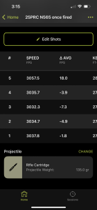

25PRC, 58 grains of N565 around 3040 FPS out of a 21.25” barrel with a 135 Berger. I am trying to find someone to change the headlamp to 25PRC. Arrowhead rifles posted a photo the other day with 25PRC headstamp. Looks like it was done with laser engraving.
Are you seating those 135's very close to touching? Not always but I generally have my best luck with Berger's close to touching.
.020 off. The 133’s were also .015-.020 off for me. 215 and 230 Bergers I was .010 off. I am testing 109’s right in a 6PRC. Not sure where they will perform best.
