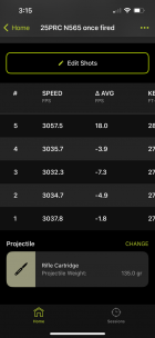

I finally got into my once fired brass with my 25PRC. The load I worked up with new brass tightened up with the once fired. This load will work very well for a hunting rifle.
And you're slinging the 135 Berger or ?? That looks like it's shooting pretty good for you and those are very good velocities for a 25-6.5PRC out of a 21in barrel. If you take #5 out and not only is that a damn nice group but outstanding single digit ES too.
