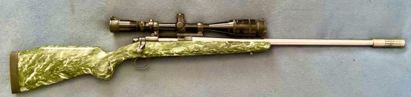

Youre right about weight, I'm going lighter with about everything now. I mostly shoot off bags on the truck hood, or between the A pillar and door, or door window, almost never go walking. And wouldn't go walking with that one unless it was a very short distance. Also I'd weighed several rifles and misremembered that one, it weighs 11 lbs now and with a different scope, 4-27 Bushnell Forge. My lighter weight one is 9 lbs with a (now) 6-24 Arken. Lilja barrel, very nicely accurate with same loads, a bonus.. Haven't used it on fur yet.IMG_E0854.JPG
Youre right about weight, I'm going lighter with about everything now. I mostly shoot off bags on the truck hood, or between the A pillar and door, or door window, almost never go walking. And wouldn't go walking with that one unless it was a very short distance. Also I'd weighed several rifles and misremembered that one, it weighs 11 lbs now and with a different scope, 4-27 Bushnell Forge. My lighter weight one is 9 lbs with a (now) 6-24 Arken. Lilja barrel, very nicely accurate with same loads, a bonus.. Haven't used it on fur yet.View attachment 1700240

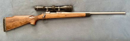

Mine Looks like Yours, only it's Still, Blue steel ( Lightly used, 1981 Model Rem 700, Lefty, in .22-250 ) w/ 6x-20x Burris and a Brake. With the Load, mentioned above, it DOESN'T, "Move",.. upon, Recoil !
I really Like, the 7 to 8 Pound Rifles for, "Walking Varmint", Hunting.
I use this Rifle for, Walking the rolling desert Hills, in Sage Rat Country w/ My Wood Sticks and a Pack on My thigh.
The Pack supports the Rifles Toe area for, Good Accuracy in Sitting Positions, on the Side Hills.
