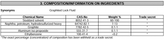

Lock-ease is not alcohol as I mentioned above. It has been a few years since I retired so I looked it up to be sure nothing has changed, and it hasn't. Lock-Ease is mostly Stoddard Solvent, but as you can see below they throw in some additional solvents like Ethylbenzene and more.
Stoddard solvent is very different than alcohol. It is distilled alkanes and aromatic hydrocarbons.

If that's the case (and I'm not going to argue with you on that - I never looked, and simply ran with the assumption it was alcohol) I can see there being at least some amount of residual lubricants (light- and not-so-light oils and such) left after the volatile components have flashed off. Makes sense actually, if you look at it as being a treatment for locks.
The mix-your-own method of faux-Neolube avoids the issue of the oils, and, as a bonus, ends up being a lot cheaper than actual Neolube as it doesn't have to be certified for nuke plant use.
