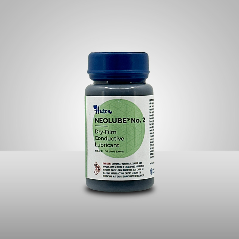

Neolube #2
I use Neolube inside new cases, like my 20 Vartarg or 17 Mach 4 cases, so I got a pack of very small tipped foam applicators off TEMU, and those fit into both the 20 and 17 caliber necks. No wood or fiber dowel to soak up the Neolube, so it goes a long ways.

2 Fl.Oz. basically being a lifetime supply unless you spill it…. ;)
I spilled it. Not much but it do make a mess (or I do make a mess is more accurate).
I have found a big qtip (Ramrodz is what I use) that has been dipped in the container and has dried out, will still coat the ID of the neck well enough for using a mandrel.
