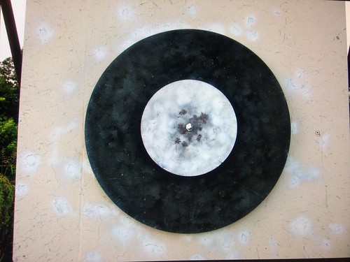

When I fire 15 consecutive shots as required in Palma matches and they're all like this I can't find much reason for driving back and forth!
15shot by Sharps Man, on Flickr

Here's the latest: Ten rounds from 900 yards. The AR500 plate is 32x34" dimension.
308 Win/Remington M700 factory barrel/action by Sharps Man, on Flickr
