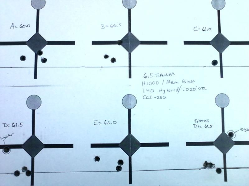

I just want to share my 6.5 SAUM 4S .296" neck results. Shot off bipod and rear bag. No Chronograph data, and wish I did. However, next time I will during seating depth test. After seating I plan to revisit power charge in smaller increments.
Load Data:
26" McGowen barrel
140 gr Hybrid
Rem Brass
H1000
CCI-250 Primer
jam -.020" OTL
