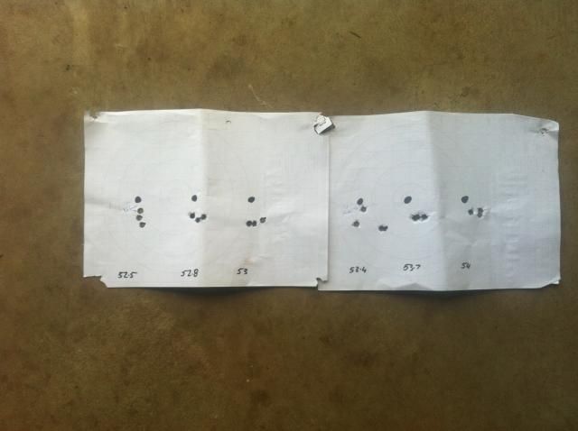

Long range load development at 100 yards.
New 284 shehane barrel
Note 53 is actually 53.1 as I was testing in 0.3gr increments, I missed the .1 as I was focussed on the mosquito bent on sucking the life out of me rather than finishing what I was writing.
At this point Im looking at 52.5 to 53.4 but will be focusing closer on 53gr for now. Quite impressed with the size of that node!
I have a buddy in the US at the moment and hopefully he brings me back a nice new Magnetospeed V2 or V3 next week to do more testing with.
Possibly, but 52.5-53.4 the groups are pretty much smack on 30mm from my datum line, where 53.7 is 20mm and 54 is 10mm so not on the same level.
The first shots of 52.5 and 53.4 went high, I had cleaned prior to those tests and fired one fouling shot before starting the tests, yet consistently the second shot after cleaning was out of the group, with the third and rest being into the group. At least it showed consistency.
Erik- My magnetospeed is sitting on a shelf somewhere in Texas hopefully, it will travel to the southern hemisphere to me sometime next week. Until then Im chronographless.
I took another look at the sheets today. While im convinced that 52.5-53.4gr has something in it, Im going to load more and test 53.7 54 and 54.3gr again (no pressure signs) as there could well be something else up there. Might be able to borrow a magnetospeed wednesday and get an idea of velocity.
I will say the 53.4gr group I shot with my joystick hard to one side (had to lean on it) and think this really upset the gun handling.

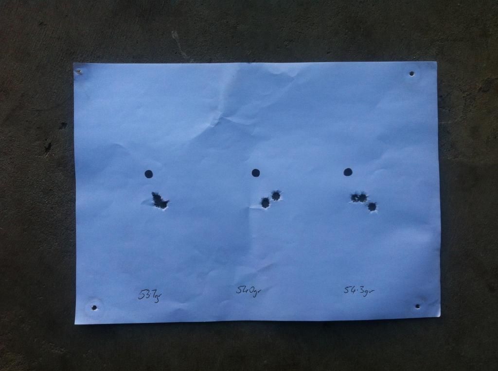

Well you guys were definitely onto something! I loaded up 53.7, 54 and 54.3 but changed projectile from the berger 180 vld to the 180 hybrid. Ive never found much difference between the two. Obviously its not a bad thing! Still havent played with seating depth yet, nor have I got any chrony data.

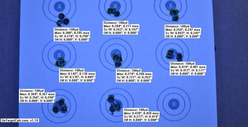

I decided to give the jump test a shot. 155.5gr Fullbore Bergers in my F-TR rifle shot prone off a Duplin bipod. What do you think, 82.77mm or a bit shorter to leave some room for error?
