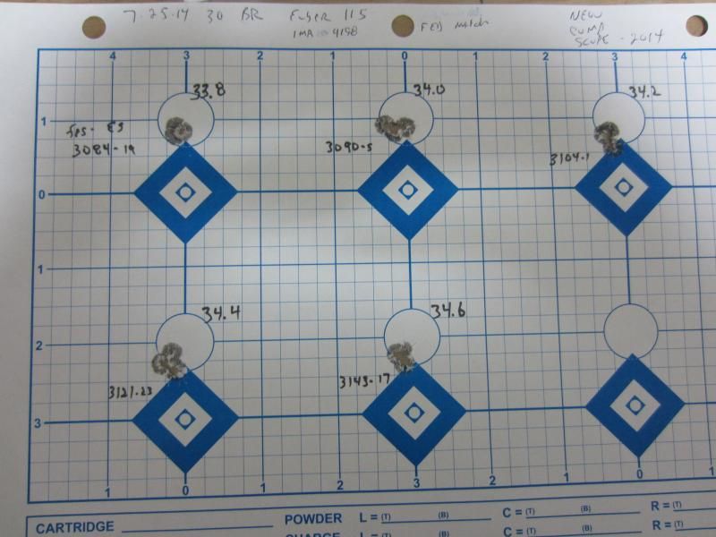

Ran out of the the 110 grain bullets I had been shooting in my 30 BR. 34.2 grains of Hogdon 4198 at 3140 ftp was the load. New bullet is 115 grain. I started
the test at 33.8 and went to 34.6. 34.6 was the velocity of the old bullet. No chance to test anymore before the next match. Which would you
load for the match?

Wow that gun is a hammer. Easy to find a load when one is consistent as that.
Geronimo Jim, I wish your test was broader as your first and last groups are the best. These were shot at 100 yards, what distance is your match at? For score or group?
Thanks a lot guys. The gun is used for groundhog matches. Trying to hit the 10 ring which is about 1 inch. We shoot at 200 - 300 and 400 yards.
My old load was 34.2 with the 110 bullet which gave me about 3140 fps. Match is Tuesday so I won't be able to test anymore.
Gun is a Bat B action with Kreiger barrel in a McMillan long range stock. Just put a Nightforce 2014 comp which I love.
Thanks again for any and all imput.

I would test on each side of 33.8 and on each side of 34.6 if pressure is not too high. If I had to pick one of the current loads, I would probably go with 33.8

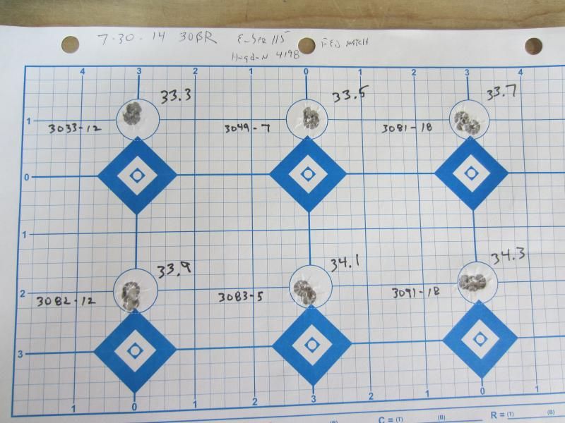

Since 33.8 looked like best load, decided to test at low end (somehow I didn't see Erick's post.) Strange....almost same velocity for 33.7 - 33. 9 and 34.1. I shoot at 200 - 300 - 400 for score.
While shooting the 33.7 load, I felt like I pulled one.
The area just under full pressure where velocity and ES do not change is where I want my loads. They are more temperature tolerant and stable. My previous .300 WSM barrel showed a .8 grain range and was the best 1000 yard load I've had.
