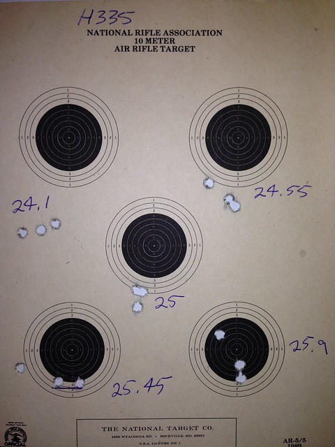

This is my first try at developing an accuracy load for a rifle. It is a low buck effort.
I know I won't be shooting any true long range with this rifle, but I figured effective load work up counts no matter what the range.
Remington XR-100 purchased used. .223REM, barrel shortened and re-crowned at 22" by the previous owner, 1/12 twist, bedded but no pillars. Unertl 1.5 20X glass.
The ammo is fully prepped LC13, fire formed then loaded for the third time to start the testing. Sierra 52gr HPBTMK. Powder used was Hodgdon H335, CCI400 primer. No wind flags, no chrono data.
POA is the same for all bulls. I would like the groups opinion about the charge weight test before I post the targets from the seating depth test. Thanks!!
XR-100 by zweitakt250, on Flickr

You might need to try going higher on your charges as your ES are quite high.
300 RUM said:
Anyone care to input on this target?
It's really hard to read the target. I can't tell what order the groups are in.
However, group #3 and #4 (written with sharpie) are both good. Hopefully they are consecutive, if so, load between the two.
Erik Cortina said:
They are shoot right to left starting on the middle right. The powder charge is hand writen in the upper left corners

The sharpie numbers don't coincide with the numbers on the group data. I don't see a powder charge on the group with a #4 written with a sharpie.
I'm liking 24.5 as the ES is better there.

24.2 is the charge it is written with in the group data.... Should I try to up the charge some also at it's highest it is 99.9%
RUM - if I am reading correctly you have gone from 23.8 to 24.2, where as all the other increments are .2 increases. This could throw the conclusion out.
It might be worthwhile to run 23.8, 24.0 and 24.2 and 24.4 and 24.6 with the intent of two separate areas to look at. i.e. validate 23.8 -> 24.2 for vertical POI stability and ES.
My suggestion is to also re-look at 24.4 and 24.6. they appear to have consistent ES of 18 but the vertical center is also very similar albeit not as tight but I suspect seating depth might bring that in. You could shoot 24.4, 24.5 and 24.6 to see how it looks with a view to settle on 24.5 and then do seating depth.
If 23.8 -> 24.2 is validated then I would look to work within that range in preference to 24.4 and 24.6, although the ES is a little on the high side.
Over to you on the fill ratio and trying higher charges.

Yes 24.0gr is missing they feel to the ground and did not want to shot them.
Target #5 24.4gr I would say they are victims of excessive rifle movment.
I wanted to load 24.8gr but ran out of time to shot them, will through chrono tomorrow to check ES and SD

cool, that may actually align with POI of 24.2 in which case you could be looking at 24.2 -> 24.6, leaving better ES numbers around 24.4 -> 24.6.
Personally I would re-validate but it might pay to get the bench setup fixed first. In part I say this because you have small groups with okish vertical POI but ES on the higher side, and further up the powder charge the groups are opening up a little but ES is looking better or at least moving in the correct direction.

These were siting 0.010 off/jump what would be your guess on seating adjustment?
If your reloading practices are up to it I would follow Erik's advice and make .003 adjustments. It isn't easy to get tolerances down that low in which case I would work within whatever tolerance you can manage as that's how it will be going forward - there is no point in tuning to a level that can't be sustained (IMO).
With respect to starting point I never jam so I only ever start from jump .005" and go from there, so your choice on where to start. When you do the testing keep using the chrony.
The only other suggestion I would make is leave off the group size data for now, it makes it hard to read the targets and up to this point you are less interested in group size (within reason) and more interested in chrony numbers and POI vertically.
