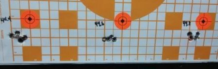

Re: This is another good one-at least I think
skiutah02 said:
skiutah02 said:
I also confirmed that the 43.6 load shot OK at 300 yds with an 11 shot group (pulled one). I'll post that target in a bit. Drew
Sorry Erik, its a Savage.... The sticker is 1" for reference
Erik Cortina said:
That's a pretty consistent group. I like it.
Thanks. I have not had too much success in testing seating depths during load development in the 308. It usually turns out that my starting point is the best (by coincidence) or the load is virtually insensitive to seating depth (to a point). I believe that you are advocating that seating depth nodes are 0.003" apart and most of my tests have been in 0.005" increments. I'm agreeable to test this theory. Do you suggest 0.003" (or less) increments from the tested depth (0.020" in my case), or start from jammed and work out in small increments? I'm thinking about trying 4 each of 0.015", 0.018", 0.020", 0.022" and 0.024". Thoughts? Drew
Up to this point I have been fine getting a load that consistently can hold 0.5 (or less) MOA vertical and has "good" ES/SDs and taking it to matches (I shoot FTR) without too much fine tuning because my ability to read the wind (windy in ND) has been the limiting factor for me....

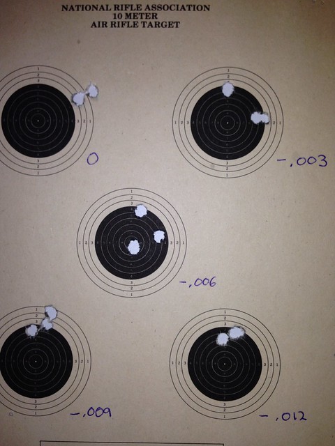

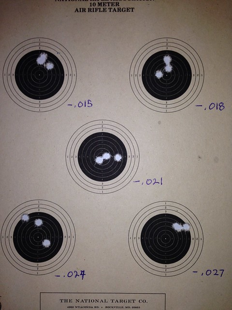

No input on my original post here, http://forum.accurateshooter.com/index.php?topic=3814361.msg36428331#msg36428331.
But moving ahead, these are the results of my seating depth test:
XR-100 by zweitakt250, on Flickr
I fouled up the -.024" target when I lost a change in the wind and mirage. Other than that it seems to me the the rifle prefers to jump from .025 to .03 inches. With better bullets I may have a decent little shooter here.
Erik Cortina said:
-.012" to -.015" look best to me.
Thank you Erik.
I have learned so much from this thread. Those who have been there and done that can see beyond those of us who haven't. With two trips to the range I have gathered what I think is quality data. There is no way I could have moved that quickly if it weren't for this thread. Some of the money saved in not burning up powder and bullets will go to help out the forum ;)
Tzed250 said:
Thank you Erik.
Glad to hear that. This forum has saved us all lots of money over the years learning from each other's experiences.

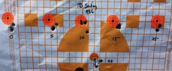

Yes, test in .003" increments. If I get around to it, I will post a target with .003" increments that outlines the nodes and also shows really narrow nodes (bad) that someone going in .020" increments would have picked.
Here is my seating depth test. Went with 0.005" increments from just touching the lands to 0.025 jump. Took two shots with the 0.020" jump (already tested so have OK idea of how it shoots) to warm up the barrel, shot the 0,5,10,15 and 25 then finished with 3 shots of the 0.020". So the lower group (labeled 20) has five shots - two from cold bore then three with hot barrel (ambient temp was 93o), the rest 3. I am not a talented enough a shooter to discount the fact I MAY have pulled one on the 0.010" group, but it did not feel like it. I'm going to run with 0.015". If I get neurotic, I may try 0.013, 0.015 and 0.017 down the road. I also wish to see how she does at 600.
Erik,
Of all the stuff you thought us, I reviewed Tzed250 targets and figured .009" to .018" seems to be end to end node with .012"- to .015" the center. If it were me, I would choose .013". Good stuff!
