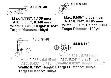

Hi, I was wondering if I could get your advice?
This was shot in blustery conditions, generally between 10 and 15 mph. I am using a Remington 700 in an AI stock, 308 calibre. The bullets are 155 Palma SMKs over N140
43.0 grains seems to be the best, but 44.0 also looks good, but is only 0.2 grains away from maximum. Any suggestions gratefully appreciated.
Kind regards
Gareth
Gareth - it is hard to interpret the target, in part because the powder increases go from .4, .2, .4.
There is a lot of information about individual groups but what you are looking for is a consistent (vertically) group centre between powder charge increases, this information coupled with reliable chronograph settings is the foundation of the 100 yard approach in the thread.
Your comments seem like you are looking at the vertical within a group as opposed to vertical centres between groups (powder increases).
Posting the native targets will make interpretation a lot easier.
Within reason don't worry too much about group shape at this early point, look for consistent POI of centres and ideally a flattening of the chrony numbers between consistent powder increases. This would produce the powder charge to work with. Group shape can then be improved with things like seating depth. Seating depth can have a dramatic impact on group shape.
Personally I'm sold on seating depth and a tuner for the ultimate in group shape but that is another story....But Erik can help on that one as well ;)
