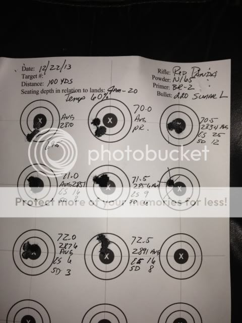

Started all over one more time as I ran out or VV165 and not any around me so I found a couple of #'s of H4831. Was able to get the chrono data this time.
Pressure at 47.4g?
To me, your scatter group looks to be at target F or 46.8g. It looks like a scatter to me because you have 2 holes at the previous POI and one hole at your new POI of 47.4g. Also, target G your POIs are moving down the page to the new POI at 47.4g. Therefore your nodes (OCW anyway) should by 1.5% higher or lower than that group which would equate to 46.1g and 47.5g. The 46.1g group area does not look promising because the POI is different than the groups before and after. The 47.5g group does look promising but you need to shoot above the 47.4g group if you do not have pressure to see if the 47.8g group has a similar POI to the 47.4g group.
I doubt he has pressure at 47.4 since most match loads with 6.5-284 and H4831 are above 50 gr.
My advise is to keep working up to higher powder charge and see how it performs. Stop immediately if you encounter any signs of over pressure.
