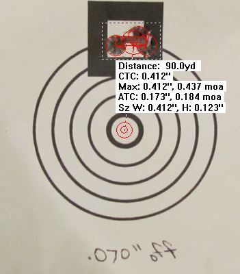

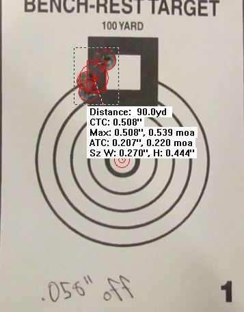

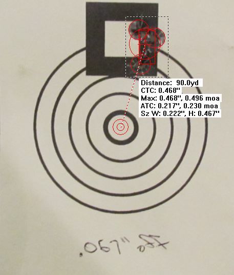

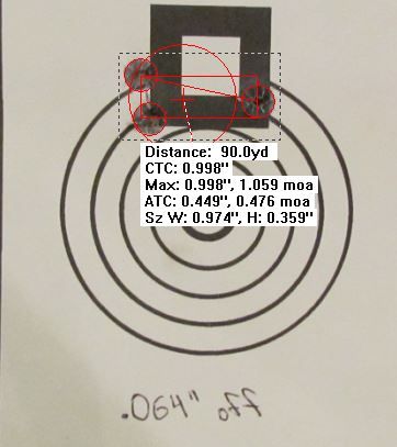

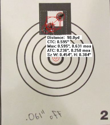

Tested my 284 win yesterday with the 52.8 grain charge you guys suggested. Here are the targets. There was a 1/2 MOA adjustment right after the .058" off group.
Well, what is interesting is that the groups opened up then tightened again. What happens at 0.050-0.056" off, as well as 0.070-0.076? I think what you found was what we'd call an anti-node, and its worth doing a little
more to see what happens around those ranges.
My gun does not like these bullets any closer than .045 from the lands, like it shoots 1.5-2 MOA. I will see if i am able to seat out to .076" off without hitting the donut, i think i am though.
