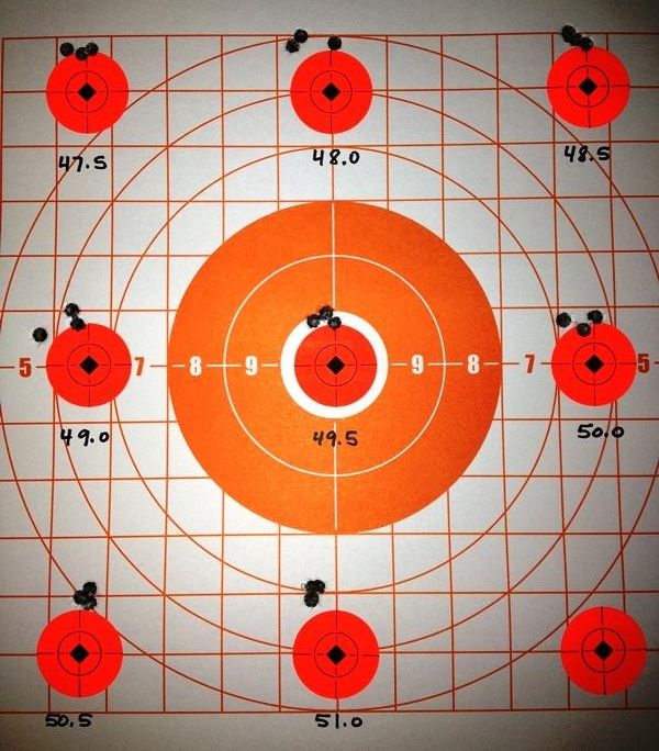

Here is an interesting one...load development on 6.5-284...140gr Berger VLDs jammed .010"...4831SC in 1/2gr. increments starting from top left at 47.5 and going in order to 51gr. Very little vertical difference between charges at 100. Any thoughts?
BoydAllen said:
Would 51.5 be too much pressure, and could you fit it in the case?
Already loaded up some 51.5 to test along with some more 51.0. Was in a hurry to get to the range with new gun and forgot my chrony too.
This was the first 24 rounds down the barrel...The throat on the gun is a hair on the short side so i was really just testing pressure signs. Even at 100 degrees outside temp there were no ejector marks, primers still looked good, and bolt lift was smooth.

Do you have chronograph results?

I wish I did. I was in a hurry and didnt get to chronograph. Going to duplicate the test over again over chrony...was just itching to get some rounds downrange out of the new gun. 50.5-51.5 should put it in the 2900-2950 range.

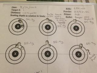

Here are mine ! please comment on what you think is the sweet spot....
and for comparison and to see that if it shoots at 100, it will most likely do good further out. Here is an 800 yard target. C1-C5 = 54.5 and D1-D5 = 55
At 800 I was holding center of X and not compensating for wind. The wind was blowing at 10-12mph from left to right as seen on target.
