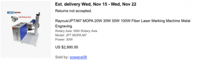

Aaron, are you engraving the plate & barrel with ezcad or have you installed lightburn? Asking because I have taken a chance and ordered one from eBay/China.
Thank you,
Hank

I’m 99% sure that’s the one I have, mine is a 30w. I use lightburn.
I had a Polaris Ranger and a buddy had this engraver, we figured out a mutually beneficial trade and I now have the laser. The major advantage is he gave me all the settings for stuff and the setup. The previous picture is 3 different settings deep engrave, dark engrave and the bottom one is a deep engraved with a white pass (removed all the black).
