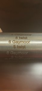

I shoot for .01" for both barrels and serial numbers. I do my engraving before any coating or finish work....most of the time. You can do it after, but you have to run an offset cleanup pass to get rid of your slag ridge.
Dumb question... You achieve that depth by doing multiple passes, right? The machine specs say something like .003 depth - but I'd just do a bunch of passes to get to the desired depth?
I'm sure I'm botching terms here, but you know what I mean
Not a dumb question at all. Spot size, wavelength, galvo velocity, repetition rate pulse energy and number of passes all contribute to depth of cut. I know all the factors, but not all the answers.

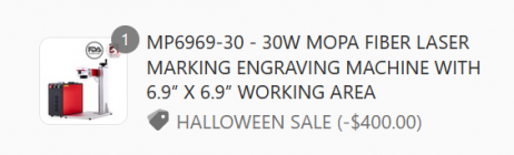

Looks like the $400 sale is still active. So tempting. That pays for taxes (Georgia) and shipping...

Probably not enough for the price difference. US based support, allegedly tested, US stock, etc.
