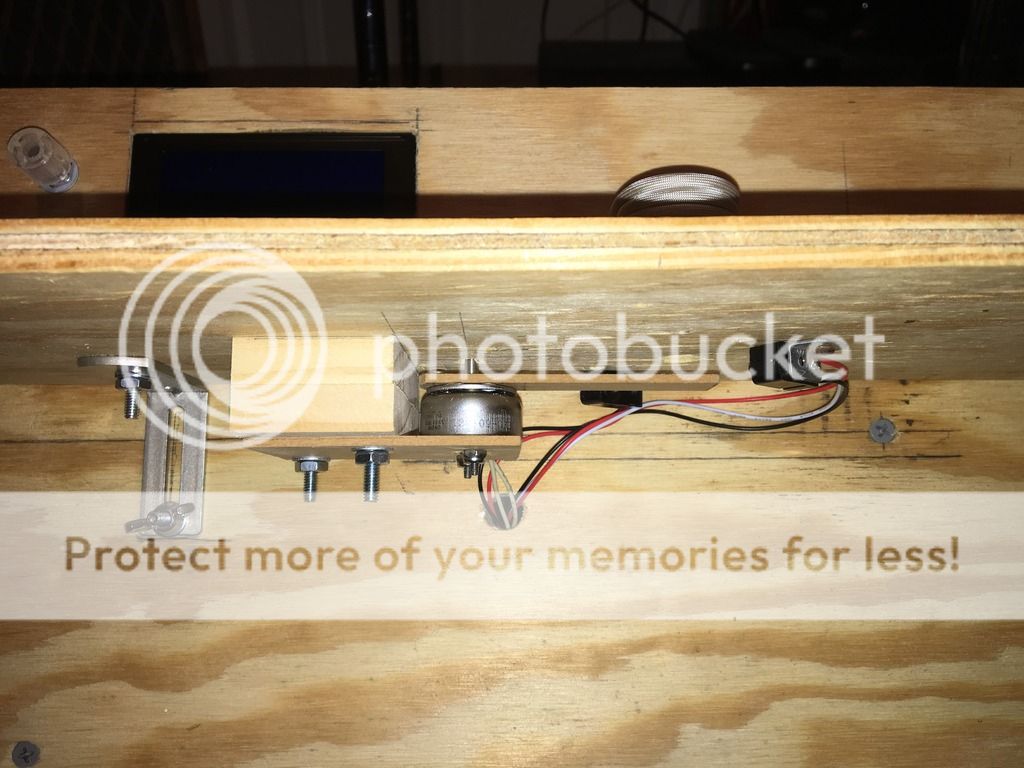

I started out using a servo for the trap door, then I went to a linear solenoid. Thought I'd also try out a rotary solenoid as well. Short term it's working fine but this is just a crude setup but seems strong enough and it's far enough away from the induction coil so it doesn't heat up. Big issue with a rotary solenoid is finding one for a decent price.
Crude is in the eye of the beholder. It works !!! and that is the really neat thing. Major inventions start that way. You saw a need and thought of a way to get it done.
