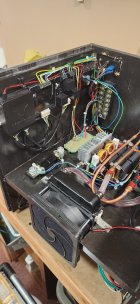

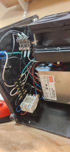

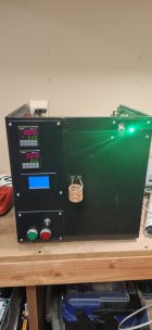

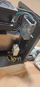

I have an induction annealer I want to sell that I made years ago using the info on this site....all that needs to be completed is the solenoid mechanism to drop the brass. I have two solenoids for this...the mech just needs to be finished. It is working as pictured and was programmed using a plc as I recall ...program was posted here ...I made this to use with my dillon press and it turns on and off the outlet at the bottom. Make me a reasonable offer.
