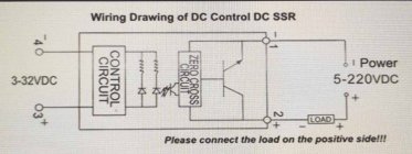

Decided to go with the SESTOS DIGITAL QUARTIC TIMER AC, got everything running Timer is counting down stop start is working, but not connected, to the induction board yet, still waiting for the water pump, and solonoid, my question is, I am using a SSR-40DD, do I make the connection from this to the induction board, through the pos, or neg wire. Also do I need anything for fly back,think that is what you call it, like a 1N4007, diode if so how to install it, like to thank all the people that have helped me.
Decided to go with the SESTOS DIGITAL QUARTIC TIMER AC, ....... my question is, I am using a SSR-40DD, do I make the connection from this to the induction board, through the pos, or neg wire. Also do I need anything for fly back, think that is what you call it, like a 1N4007, diode if so how to install it, .........
I have tested my build using a SSR-40. My understanding is the fly back circuit is internal to the SSR, so I did not use one. Here is the way I connected it:
