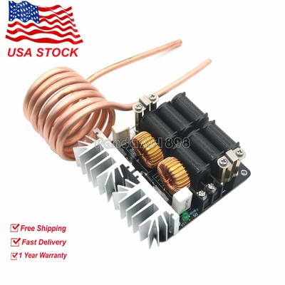

I ordered this one:
It seems I already have the rest of it except the tiny water pump. Enjoyed digging around in the conex boxes where my junk assortment is stored and found a whole bunch more brass, powder and bullets I have not seen in several years.
