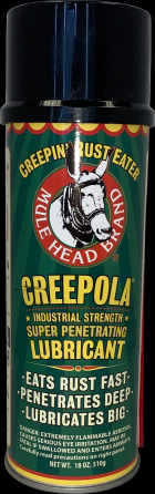

If you like FreeAll, see if you can find some Creepola by Mule Head Products. I've never used it on a barrel, but I keep it around to use as a last resort before I break out the torch for farm equipment repairs on a sea island. It tops any product I have ever used and it sells so quickly the parts store has to keep it in the back room and ration it.
I might get around to trying it myself.
Go to Creepola and scroll down. View attachment 1448231
you may have the mule Kick right there...I didn't think Free All would do crap till I tried it..it melts carbon somehow
