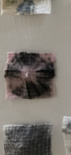

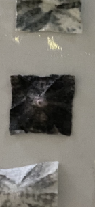

First patch was throat area, second patch was 1 push through the barrel, mixed up some think it works but this rifle hasn’t been cleaned in years.
