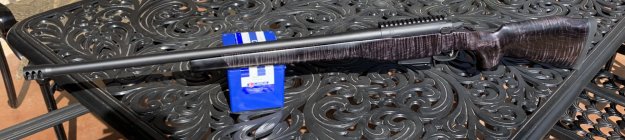

This Xring was done exactly like described View attachment 1412359

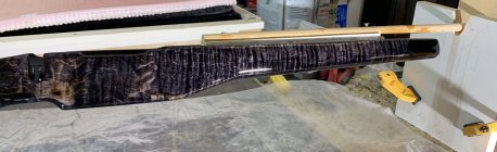

Sanding then polishing to just a touch off full gloss. It was blinding me with the reflection, showing every fingerprint, ......o_O This one is a hunter, not a show gun.
This was an experiment. We wondered what it would look like. Now that you’ve seen it, you can send a stock to Bc’z and he’ll put a shine on it.
