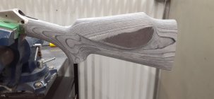

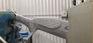

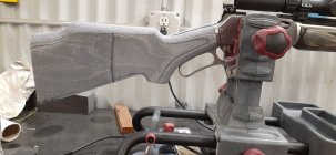

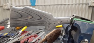

I added a wooden butt plate after shaping it, I cut out the bolt recess then started sanding
After sanding, I applied true oil then sprayed the stock with Spray Max 2K clear glamour.
