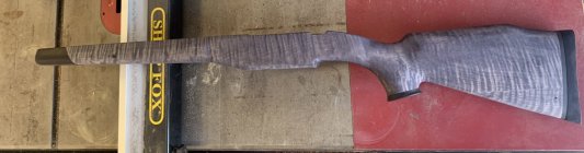

Finished shaping, cut the bolt slot and first coat of black. I got frisky and tried a little flair on the grip cap. I think I’m going to do a rotisserie epoxy coat on it. The grain in this piece doesn’t warrant sending it to Bc’z.

On maple with for sanding back, try wiping the wood with water first. It may help with the blotching. Also, I think you could dilute the black a lot more and do more coats where the figure looks ok.
Sometimes, doing a different color for the sandback like red or brown and then a dilute black can work out nice and bring out different tones.
Check out Charles Neil on YouTube and also how Paul Reed Smith dye their guitars. PRS uses a combo of oil and alcohol based dyes.
If you used alcohol dye, try wiping with straight alcohol and sanding the blotches. It probably won't do much but it may strip the dye a tiny bit.

Thanks. I’m going for just black on this one. I sanded to 320 and put on that coat with plans to sand 400 and 600. I’ll check out those vids.

Put a STRONG coat of black on then knock it back really good with 320, dilute with water for next coat, repeat, after doing this 3 times, I go to 400 grit diluting the dye with each subsequent coat.
I like my 1st coat really strong to set in the soft grain well.
This rootbeer dye job had a mix of 70%black 30% medium brown to get the ball rolling. 20230210_131648.jpg
This side doesn't have the figure at the opposite side, but still good character 20230210_131709.jpg20230210_131721.jpg
Test on some scrap. You'll probably find the higher sanding grits have a big effect on your dye penetration. You might be able to use finer grits to limit some of the dye overwhelming the endgrain.
Well, I hit the shop early and got started. Put on a dark black coat and sanded. OK, still blotchy. Tried a couple more times with lighter coats. Sanded it down to 600 and tried again. Worked up a pretty good sweat along with a headache. I broke for lunch and some Tylenol. I took a moment to reflect. I wanted a black stock, I’m not Bc’z and I’m running out of time. I went back out to the shop, hit it with a dark coat of black and called it good. I set it up in the rotisserie and put a coat of epoxy on it. It’ll spin until tomorrow, get a light sanding and a second coat.0C6EEEDC-EE16-49CB-8E8F-C8050F8E5380.jpeg1C5E3A56-CCDF-4F56-B00C-30CAD46DE9BB.jpegDFBD285A-B01B-4F39-978D-06E2719310B0.jpeg94B3ECA3-907C-4BA7-83F4-FE120756CAE6.jpeg

Well, I hit the shop early and got started. Put on a dark black coat and sanded. OK, still blotchy. Tried a couple more times with lighter coats. Sanded it down to 600 and tried again. Worked up a pretty good sweat along with a headache. I broke for lunch and some Tylenol. I took a moment to reflect. I wanted a black stock, I’m not Bc’z and I’m running out of time. I went back out to the shop, hit it with a dark coat of black and called it good. I set it up in the rotisserie and put a coat of epoxy on it. It’ll spin until tomorrow, get a light sanding and a second coat.View attachment 1411741View attachment 1411742View attachment 1411743View attachment 1411744

I’m not unhappy with it. The grain still flip-flops in the light.
It’s for a Surgeon actioned 6.5 x 47 with Atllasworx bottom metal for AICS magazines. Hence the tactical look.

That’s nice of you to say. After the last coat of dark black, I let it dry then wiped it down with alcohol soaked paper towels. I think that’s why I got the highlights of light brown grain.
Thanks for telling me to go dark!

I just went to check on it. Here are some pics:View attachment 1411792View attachment 1411793
I think that looks pretty dang cool! The light grain lines over the black fiddleback is a nice surprise. I like it and I think what you were a little dismayed about earlier is not even there anymore. Very cool!

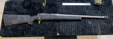

A bit off topic for me but I got bored.
I was in the shop watching the stock spin. Having some free time, I pulled a mahogany 40x copy out of the pile and started sanding it. Another week of free time ahead involved with this next project after the last week long project, I decided to go for some quick satisfaction. Instead of heading to the local Pawn shops to look for a new old gun, I decided to just use what I had on hand.
I gathered up the parts I needed and got to work on a 30br hunting gun I’ve been planning to build. Putting the wood stock off for later, I opened up the barrel channel of a factory stock I had leaning in a corner. Last summer, I bought a Lilja 10 twist nutted barrel on “leftover, client backed out” sale, half price. I had him chamber it in 30 br, .330 neck and threaded for a suppressor. I put it on a Remington SA, added a Timney trigger from the bin, found a brake to protect the threads and put it together. Total time was just under 3 hours. I’ll bed it when my bottom metal parts come in. It’ll work for single feed with the 308 box and follower in there.
I gathered up the parts I needed and got to work on a 30br hunting gun I’ve been planning to build. Putting the wood stock off for later, I opened up the barrel channel of a factory stock I had leaning in a corner. Last summer, I bought a Lila 10 twist nutted barrel on “leftover, client backed out” sale, half price. I had him chamber it in 30 br, .330 neck and threaded for a suppressor. I put it on a Remington SA, added a Timney trigger from the bin, found a brake to protect the threads and put it together. Total time was just under 3 hours. I’ll bed it when my bottom metal parts come in. It’ll work for single feed with the 308 box and follower in there.
