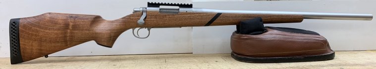

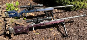

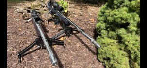

From the duplicator to the Match. It’s rewarding to make and shoot your own creation.
