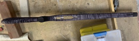

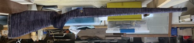

My Howa bottom metal finally came in, so I got it fitted, final shaped the stock and gave it the first dye coat. I hope this works! Pretty scary going for root beer and starting with a black stock! Maybe I should just go for black?A3090824-7B20-4B86-BD69-9B6CA358476D.jpegEFAC1D30-FCF5-4356-A5FC-1A60F842BF2D.jpeg
My Howa bottom metal finally came in, so I got it fitted, final shaped the stock and gave it the first dye coat. I hope this works! Pretty scary going for root beer and starting with a black stock! Maybe I should just go for black?View attachment 1359478View attachment 1359479
How many coats of black do you have on it now?
I've had a strong hankering to do a tacticool dye job.
If you sand it then apply more black that s been diluted 20% apply another coat and repeat 3-4 more times diluting 20% each coat until your last coat is basically a very diluted wash coat, you will have accomplished what I've been wanting to do for a while.
Hey! One heavy mopped on coat. I’m just tired. I’ll go for root beer, but the black is kinda cool.
Multiple coats sanding and diluting as you go with blak is a mind blowing effect. T-rust me!!!
If you really want rootbeer sand that shit down, do a 70-30 mix of black and medium brown 70 being black.
Follow with medium brown strong and straight. Sand that shit down and Follow with copper " medium brown and red 50/50, sand that shit down and go to vintage amber, now sand that shit down.
Follow with diluted coats of copper and vintage amber sanding between colors until you do a final wash coat in vintage amber.
When its all said and done you will have rubbed and sanded the stock 10 times.
I use 320 for the 1st 5 coats then switch to 400 grit for the remaining coats.
Take what you will from this and post pictures of the outcome.
I can't wait to see the finished product.!!!!
Jaysus, man! Now I AM liking the black more!:eek:
Don’t sand THAT shit down!
Exactly!!!
I’ll explain what I did. I sanded down the black with 400 and applied black/brown mix. Let it dry and sanded that down. Did the Amber and sanded that down. I then did a diluted mix of brown/red and liked it. So now I have the color I want! Yay, but...I’ve been sanding at 400, then 600 before the last stain coat. I’m not spraying multiple coats of clear on this stock like Bc’z does. I’m using oil and I have to get to 1000 with my stain intact. I’m using a stain diluted with water. Every time I put a coat of stain on, it raises the grain and I have to sand again. That screws up the stain. I sat and thought, then remembered the stain instructions. It said I could use water or alcohol to dilute the stain. Bingo! Alcohol won’t raise the grain! I sanded the whole stock thru 600, 800 and 1000. I filled a small tray with denatured alcohol. I added a little brown and mopped it on the stock. Not right, so I added a little red to the tray and mopped that on. Nope. I added a little amber. Nope more red. I kept adding a little of each color to the mix and mopping it on the stock, not even letting the previous coat dry. After 8-10 tries, I got what I wanted in color and the alcohol didn’t raise the grain. I let it dry for a few hours and gave it a coat of oil. While putting the oil on, I could feel minor rough spots under my finger, so I wet sanded the stock with 1200. DONE!

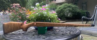

Ya know.....the more I look at that pic, the more I like it. You may be on to something. I have some more Tiger Maple around here somewhere.
