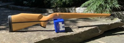

Thanks. I’m getting some of my confidence back. Almost forgot......black or classic brown? Length of pull? Some like’em longer.DB5EE594-9C43-4FB6-ACA6-61C840C78339.jpeg

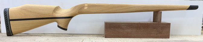

The new puppy got me up at 5:30 so I had my coffee and hit the shop early. Almost done! Sanded to 400, waiting on filler. The local Woodcraft store was out of the color I needed so I had to order it on Amazon. A special thanks to Dale (@hogpatrol), who came running up with a #3 contoured barreled action to help check the inlet for fit!
