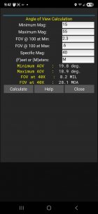

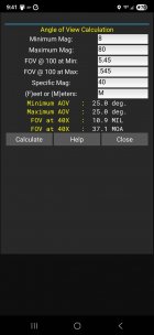

When it comes to AOV, I created an app for my phone (Turbulent Turtle Optical Tools) that when I put in the published FOV at minimum mag and the FOV at maximum magnification, the minimum and maximum magnification and specify a magnification, it shows me the AOV at minimum and maximum magnification and the FOV at the selected distance. I also created a spreadsheet in which I have accumulated the information for about 120 different riflescopes using their published values. The spreadsheet does the calculations and shows me lots of great information.
For the Comp, I had the published values from a few years back and I went to their website to make sure I had the correct values. They no longer publish the FOV values for the Comp. Undeterred, I downloaded their propaganda sheet (2024 catalog) and the values were in there on page 33. I use the metric values when they are there as I find them to be more accurate and consistent across manufacturers, but the feet/yard usually agree with the metric. So they say 15-X to 55X, with an FOV of 2.3m/100m @ 15X, and an FOV of .6m/100m @ 55x. This translates to an AOV of 19.9° @ 15X and 18.9° @ 55X. For 40X, that translates to 28.1 MOA or 8.2MIL.
For the Majesta, the published values in their propaganda for the Majesta are: 8X to 80X, FOV of 5.45m/100m @ 8X, and an FOV of .545m/100m @ 80X. (Notice how close the Majesta is at .545m @ 80X to the Comp at .6m @ 55X.) This translates to an AOV of 25.0° @ 8X and 25.0° @ 80X. Notice how consistent the Majesta is compared to others in AOV throughout the range. For 40X, this translates to 37.1MOA or 10.9 MIL.
Screenshot_20250610_094212_TT Optical App.jpgScreenshot_20250610_094104_TT Optical App.jpg

You are very correct. The Majesta introduced a very wide angle of view to the world of long-range optics with its 25° AOV throughout its zoom range. At 1000 yards, at 80X, I can see the entire target and about half of the target on either side of mine. In Lodi, I can see the complete target on either side of mine.
