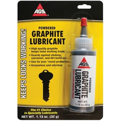

Could you guys that are using the graphite link to what you are buying please? Or just regular old graphite like this?
https://www.amazon.com/dp/B000K7TOLE/?tag=accuratescom-20
