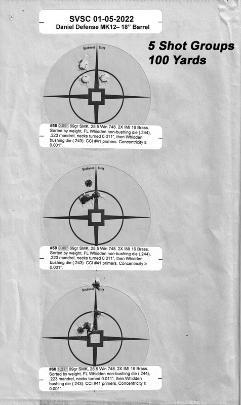

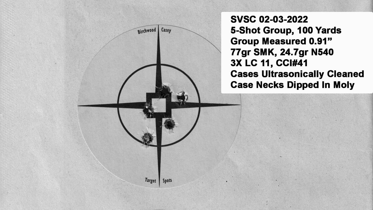

I am tempted to try your method. I have a bunch of brass that has been fully processed and ultrasonically cleaned. In the meantime I am going to use the vibratory method of cleaning. Regarding chamfering on the inside of the case mouth, I use a Giraud trimmer that I believe is doing a good job.
On Wednesday this week I loaded up some Lake City cases that were ultrasonically cleaned. Half with the necks dipped in moly and half not dipped. Yesterday I went to the range and tested the loads. My rifle was a Daniel Defense Mk12 with an 18” barrel.
I was surprised the cases that were not dipped in moly grouped better than the cases that were. The velocity spread was also tighter on the cartridges that were not dipped in moly.
BTW, the necks on these cases were turned to 0.011” with 0.0035” neck tension.
